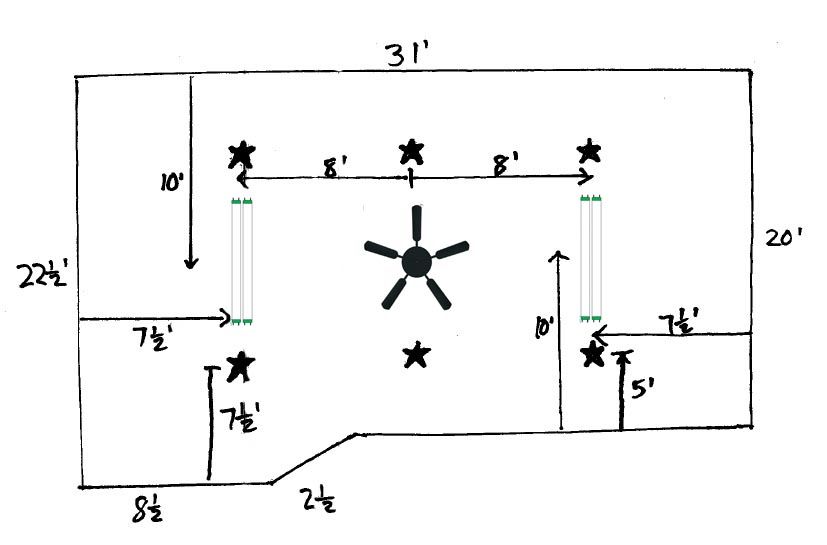

My house has a large finished room in the basement, which is the gameroom. Well, it looks more like a storage unit now, but it has potential. There's carpet squares, but the walls are a flat gray, which looks more like primer, and the lighting is insufficient. I think that when the house was built, the lighting was 'just enough'.
There are 3 light switches/circuits:
1) Ceiling fan
2) Ceiling fan light fixture
3) Two 4 foot fluorescent fixtures
I want to add more lighting for the gameroom, but also done tastefully for if we even need to sell/move. I'm unsure if recessed lighting will one day look dated, but it seems to be very common and still in use, but probably more LED now?
Looking at the crappy illustrations below, the joists run top to bottom (across the room). This means that I can easily put a hole in the ceiling and wire a new fixture one side to the middle of the room and other side of the room back to the middle/current fixture.
So, currently there are two 4 foot fixtures and the single bulb fixture on the ceiling fan. The black stars are proposed added light locations.
The most obvious, to me, way to go is
-Remove the 4 foot fluorescent fixtures
-Add can 5 feet from center on each side of where 4 foot was
-Put can where 4 foot was
-Upgrade light fixture on ceiling fan to 3 or 4 med base bulb fixture
I'll have some cans 5' and some 7.5' from the walls. They'll be 5' and 8' apart. Not ideal if you were starting from scratch with no sheetrock, but as far as running wire down those joists, does this sound reasonable and like it will be enough lighting, gameroom or not?

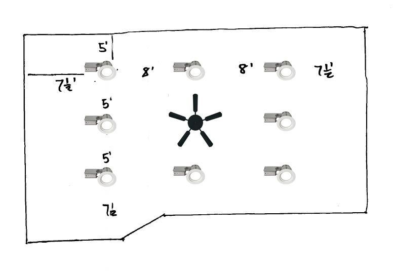

My question is mainly if that spacing will be sufficient. From what I read, there's no hard rule, and what may be enough light with wider spacing in a living room isn't what you want for task lighting, like a kitchen.
When I finished my basement a few years ago we went with recessed. I switched the standard BR30 bulbs to the BR30 LED bulbs from Philips. All are on a dimmer and the Philips are a bit brighter then a standard bulb. I dislike CFL's and suggest staying away from those. There are likely more integrated options now for other types of recessed LED that you could check out as well, but suggest doing some research on the different types. Recessed isn't going to go out of style so you shouldn't have a resale problem later on, unlike your current fluorescent.
My spacing is probably similar to your layout, but it won't have the same look as the photo. That photo has about twice as many bulbs as you would so the room is incredibly bright, like showroom bright.

LED downlights (cans) are still pricey. If you go cheap they burn out quick and are glare bombs. I always recommend buying cheap incandescent cans from home depot or lowes and then putting in LED bulbs. You can experiment with what color temp led bulb you like best.
In your above example of the cans around the ceiling fan, that's not too bad. But you will have uneven light around the perimeter of the room, maybe some wall sconces to even it out.

I plan on going with standard 6" cans (already have one leftover from another project).
