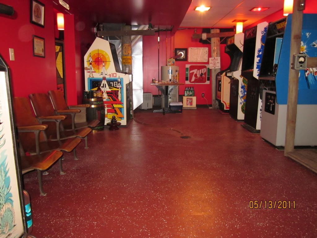

This has been discussed a lot here on klov. I used to have vinyl sticky tiles, after flood damage I now have an epoxy floor. That's what I should've applied to begin with. It was a lot cheaper (about $180 for 750 sq ft). Also, my games are on plywood stands with strips of carpet glued to the bottom so I can slide them around with ease and not scratch up the floor. The epoxy is pretty tough, but will scratch. The tile floor scratched very easily.
I used garage grade epoxy, it was pretty easy to apply, looks great, and is durable. Water flows right over it (I've had it happen a couple of times, an inch at most, which is why my games are on the plywood stands). There's other solutions to keep your floor from getting scratched, like having all your games on casters.
Tile floor:
Epoxy floor:
I used peel and sticks from lowes. Every game has sliders underneath as not to scratch it. Not too bad for $.99 a sq. foot!
