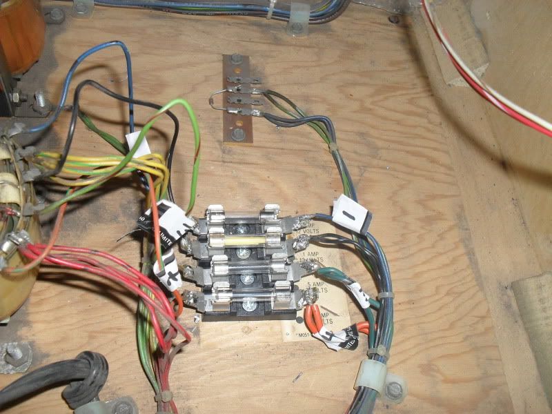

Not used my Galaxian for a few months and monitor is dead. I've checked fuses and changed the fuse holder.
The game plays blind, what would be the next process reflow or a cap kit ? many thanks Dean
#1 - the 4 position holder is not the one for the monitor. The two position one is.
