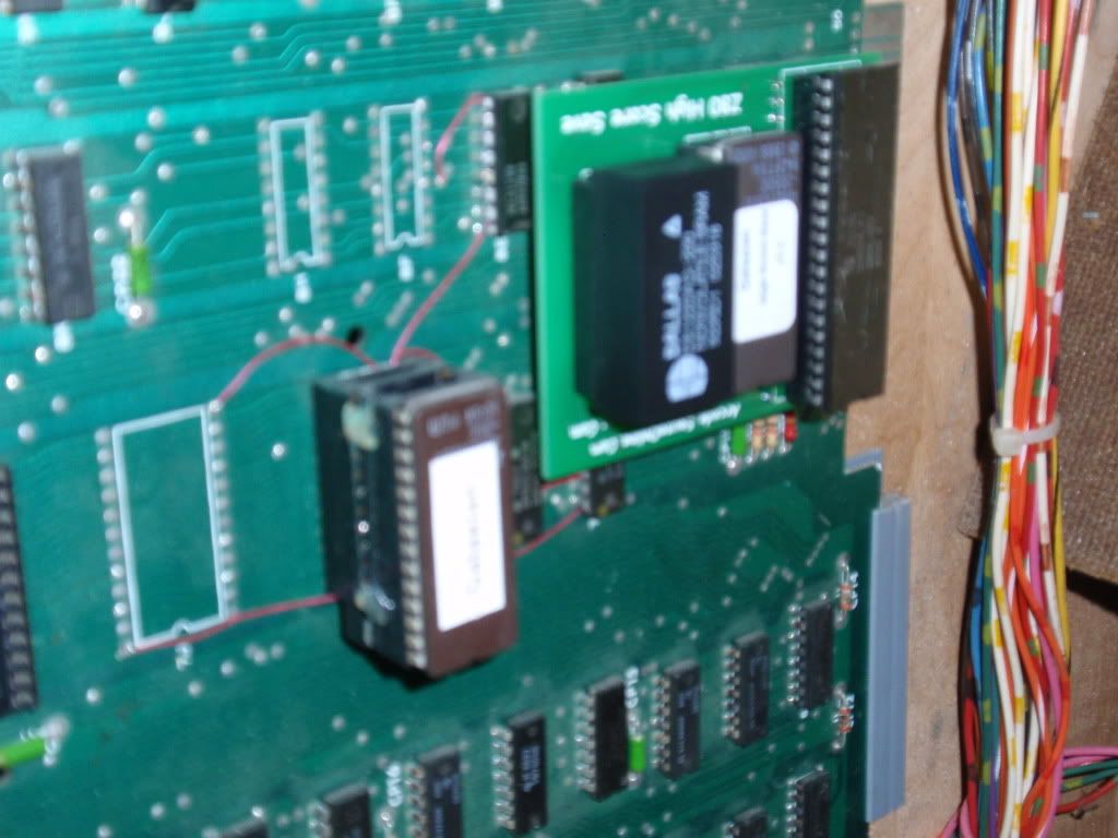

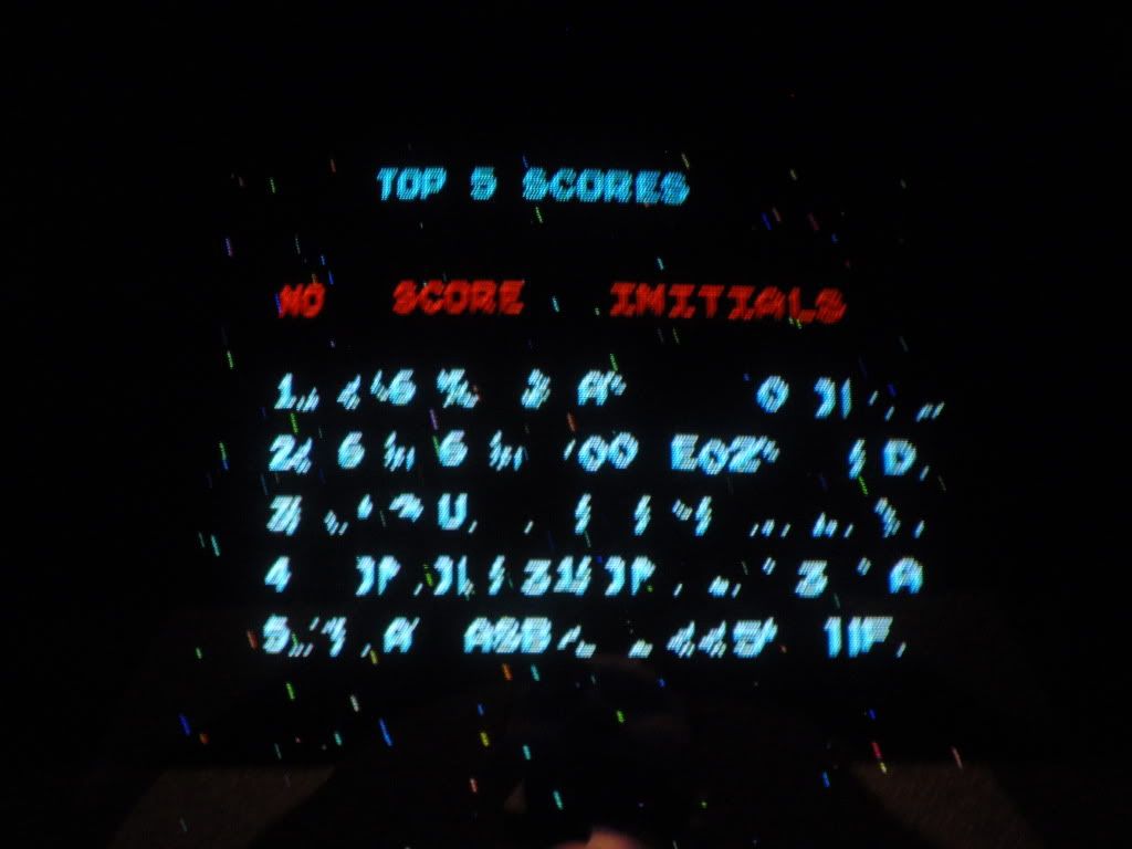

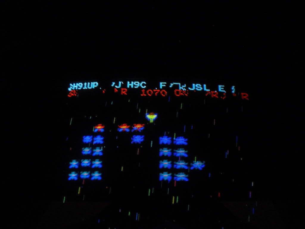

Hey fellas, I installed mine just like the picture, played thru a short game and got this:
Then, when the HS Table shows up, it looks like this:

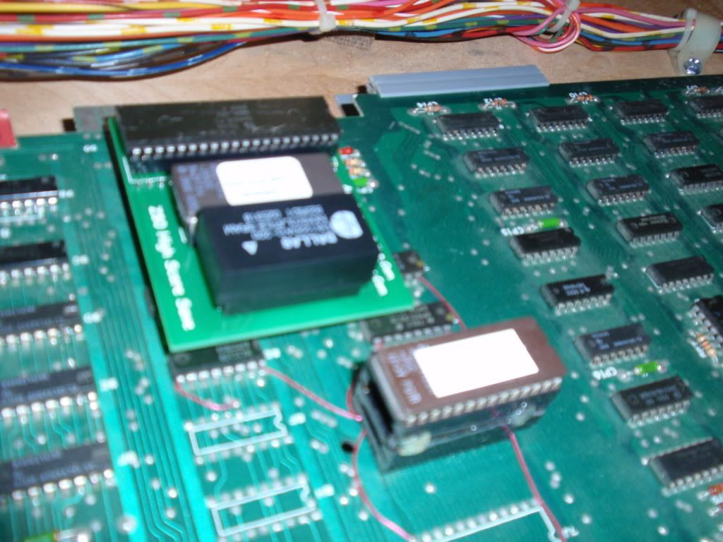

Now there is a piggybacked chip in a socket piggybacked on another socket that sits right off of the location of this kit. It has a newer label that says 'Galaxian'. Is this an add-on I should remove? It's not a daughtercard, just a piggy-backed chip.
The kit does not work with the Four Play mod from Macro.
You need one or the other... sorry
If that is not the Four Play mod and it is just a hack to remove the rom board then you can just remove that eprom and you should be ok.
I would also suggest clearing the HS table to dump any corrupt data that may be in the sram.
Yeah, I'll remove that ROM. The socket has more jumpers than the Golden Gate Bridge after a 9er's home game. How do I clear the HSS table?
Hold P1 and P2 down for ~3 seconds when the high score table is displayed on the attract mode. If that does not help then check your +5 from one of the chips. If it is low then the nvram will not work right. Should be 4.8 or higher

Yes I did, pulled the chip and the socket, HSS works. I assume I can remove the whole thing? It's got jumper wires soldered to it in like 4 or 5 spots. Can I remove the wires too? It's just dangling off the board right now.
