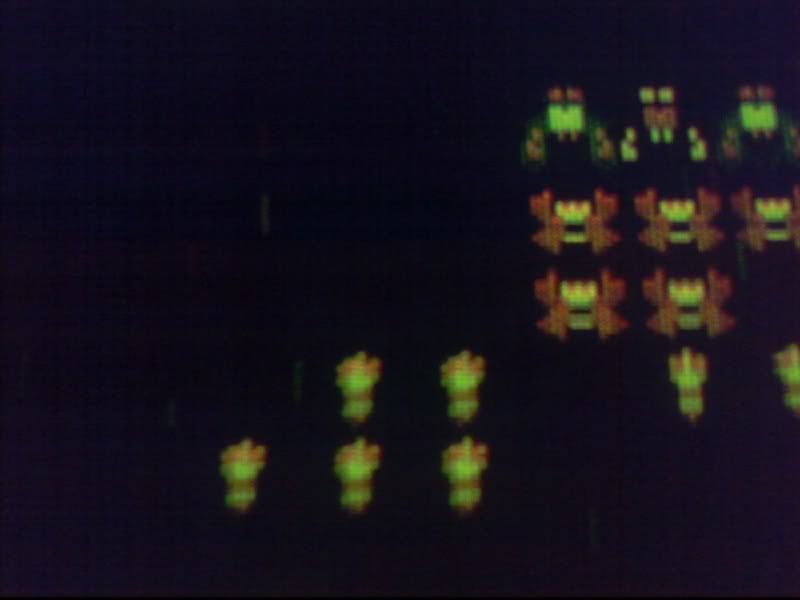

been having a hell of a time id'ing the monitor, gonna give it another shot. 3 people have tried. any ideas?

i thought i included the original post. nothing really to id the monitor with, i will post pics later when i have some time. just got it, the blue is actually black, i can see it in the starfield. i tried adjusting the pot, but all that does is turn the black to a more blueish (as in the background).

missing blue drive, open traces leading to your blue driver(s), corrupt blue driver(s).
open color adjument pot.
Bad blue electron gun, rare however does happen.
