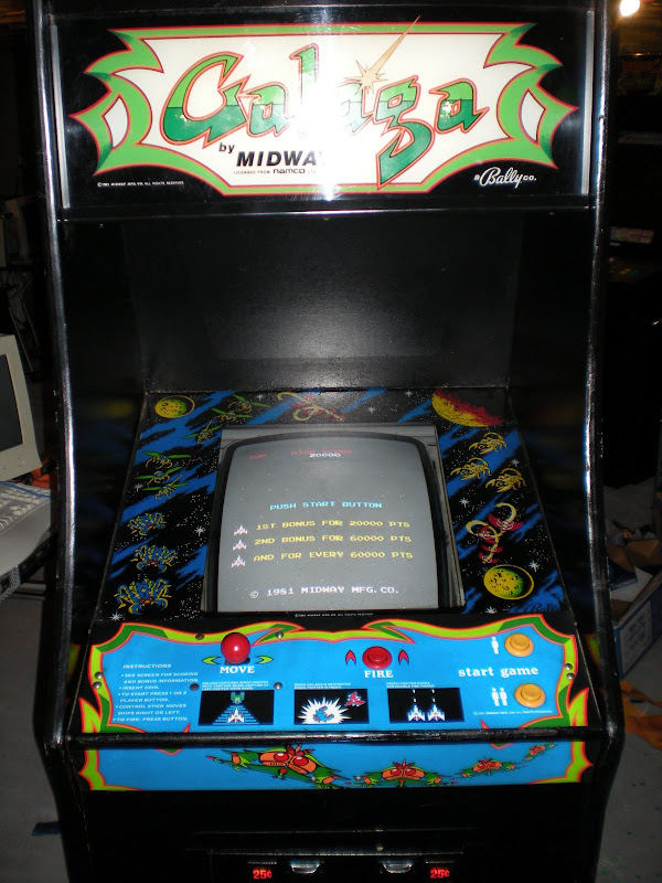

This is just a quick repair log on the state of my Galaga cabinet rebuild. Once I finally got a chance to get a good look at it, I was very surprised at how bad it really was. It had obviously been flooded at some pint in time. The base is badly swollen and the bottom piece of particle board was disintegrating. It had in fact cracked in half and had pulled away from the the sides. It was a mess.
The first thing I did was to remove the marquee and bezel, so they didn't get broken. The marquee is not great, but might be serviceable. The bezel just plain peeled all but a small border around the edge. I will need to scape it all off. I have an underlay to replace the original bezel art.
I then carefully removed the monitor and surprisingly it not only fired up, but the picture looked fantastic. So one less thing to worry about.
The bottom was the immediat issue. I removed the particle board and cut a replacement out of 3/4" plywood. Unfortunately, HD only had AA birch in 3/4" so the botton (where no one will ever see it) is a beautiful piece of cabinet grade birch ply (oh the irony).
These pics document the bottom replacement. As I get time and complete various things I will try to document those as well.

Right now, it is just a straight cut with 2.5" black drywall screws through the side walls into the plywood. I put some glue along the sides of the plywood as I set it in. I am not sure if that will help or not. When I get it upright, I will glue (Liquid Nails) some square blocks onto the top of the plywood to add support. It is too hard to try and do it now with everything at goofy angles.
The hardest part I had with it was just getting the new board in place. The bottom cabinet edges are so swollen that I ended up sliding it in and gently tapping with a hammer to get into place and then it shifted while I was putting the screws in so it is not even across the bottom. Oh well, nobody is ever going to look at it but me.
