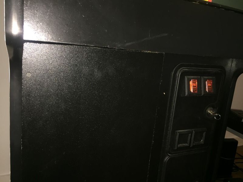

It looks like the sides of the cab have some sort of paper covering as you can see it peeling back here with the bare wood underneath. But then it also looks like at some point this paper covering might have been painted over with additional white paint.
Also, the front door accessing the PCB is held shut with a single wood screw you can see in the top left of this pic. I have noticed on other Galaga 88 cabs that they have a lock.

It looks to me that the front door to your game has been changed or re-done.
The original cabinet I had, had a lock.
