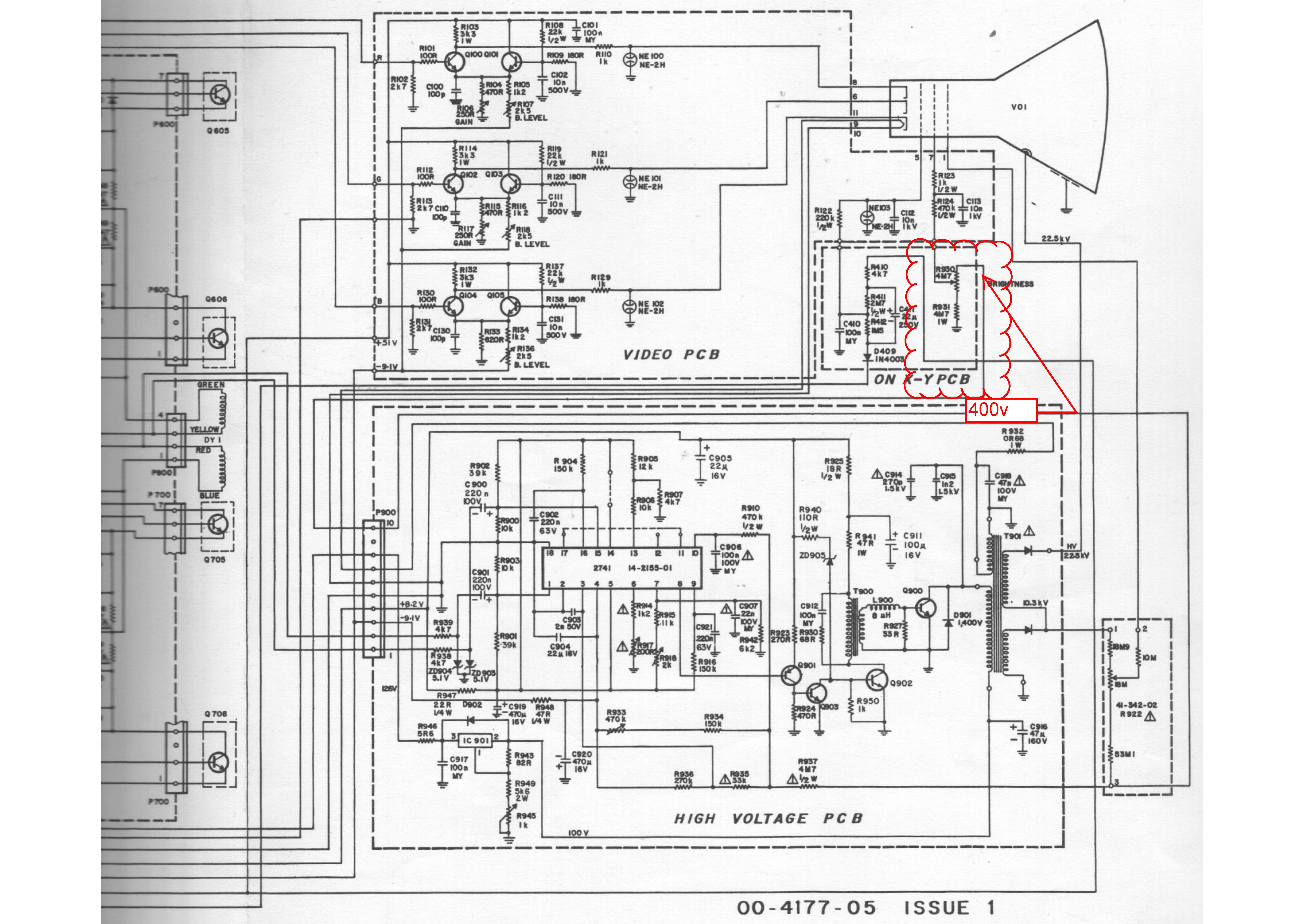

I have a G08-105 that is too bright, even with the brightness pot turned down. I'm looking at the schematics for the circuit. Do I need to increase the voltage going to the screen? Maybe increasing the value of R931? Or am I looking at it wrong....
Before you go crazy I had a brightness issue on my 19v2000 and it was the neck socket. Clean that out with deoxit and push the pins out a little so they make good contact.
