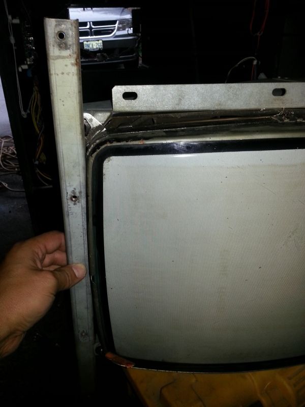

Wondering if I'm going crazy, having a brain fart or just plain stupid. The fly back on the K7000 currently installed on my Galaga is starting to take a dump so I decided to place a spare G07 I have sitting around. I started to remove the brackets off the K7000 to mount the G07 only to realize the frame doesn't accommodate vertical setup. Am I going crazy or are these monitors different? Here's a couple of photos.
Should be like this:
WTF do I do now lol?
Thanks in advance guys.
You need to source a vertical mount frame for your G07, that's what. ;)
Try Quarter Arcade, or for a last resort, you can try the arcade boneyard, but that guy's kind of a dick. I'd put up a WTB thread if you really need one.
Though for the cost of purchase + shipping, it might be cheaper to fix your K7xxx.
Thanks smalltownguy :) I thought I was going crazy lol.
I'll take your advice and fix my 7000 and use the G07 for my out run project. I'm in no rush anyways just wanted to make sure I'm not losing my marbles ;)
