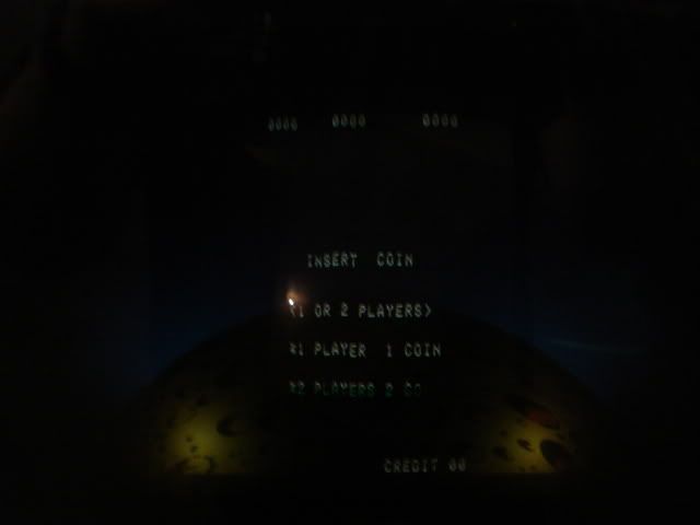

allright, so here's a pic of what it looks like. the first is a pic of the playfield. it looks really distorted. the second is the insert coin screen. it is still distorted a bit but not as bad as the playfield screen looks. and this is with it hooked to negative sync. i get a good but rolling that doesn't stop picture with pos sync.
and also, just to verify, when bob roberts talks about jumpering the negative sync on a g07, does he mean connecting the one sync wire to both h and v neg sync or using positive sync with a jumper just connecting the two negative sync pins together?

As far as your sync goes - if you have only one sync wire coming from the board, then it should either go to BOTH positive sync pincs or BOTH negative sync pins - but it shouldn't go to both positive and negative at the same time....
ok, so i have that correct then. as far as the distortion on negative sync, is there anything you think i can do about that? or should i use the positive sync and try replacing the pots to see if that fixes the rolling?
the only thing that's weird is that the sync adjustment perfectly stops the rolling on the negative sync. meaning that when i adjusted it initially, i got the knob turned to a spot where the picture just rolled into place and stopped.
however, on the positive sync side, i have to keep bumping the pot each way to 'nudge' the screen into place and then it will start creeping into a slow roll after 20-30 seconds.
