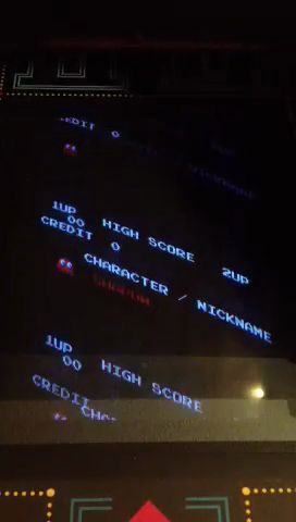

Hey guys, just did a pot kit on my pacman's G07, and now I get the picture having a high speed horizontal scrolling. Which is weird considering there's not horizontal hold pot. These are brand new pots from bob...why would this happen? Thanks guys. Any tips on adjusting new pots is welcome.

Okay, traces are good. Sync was backwards. When I fixed it, the image came up perfect! For about 2 minutes..now it's very slowly scrolling horizontally, and it'll stop, then go the other direction. Adjusting H freq, just makes it worse. Nothing will make it hold.

Standard practice on a GO7 is to reflow the input headers, meter FR901 & 908, check FR401 for rotted legs. Also check R303, 306, 314, 317 and verify they are 390Ω because some had wrong value from the factory.

Can you get the pic to square up?
You have a triple image there as well. Like I said above, the IC may have been damaged in the past since it is in a bad location. If the cover has been pulled off and someone used a metal tool to adjust the pots they could have shorted to the IC frying it. I have seen this a few times on G07s. Do you have another game or a signal generator that you can connect to the monitor? If the problem remains you will have ruled out everything on the cabinet.
I've seen scrolling for 2 reasons, and there may be more reasons that it could occur.
1. sync not correct
2. b+ too low
make sure you put back in C501 after you did the sync mod....i forgot about it the other day and my h-freq wouldn't hold...scrolled all the time.
