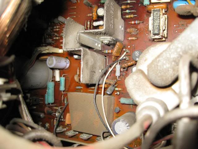

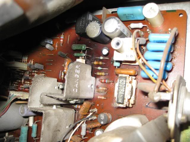

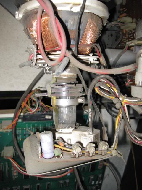

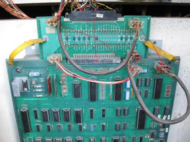

I just picked up a cabinet, playing blind with a G07 in it. This will be my very first time troubleshooting a monitor on my own. Have pity and help a monitor noob? The first thing I saw was that pesky Pac-Man filter board. Could it be causing the problem? When turned on, the monitor pops and makes staticky noises like a monitor normally does when it's working. There is no neck glow, however. I found the G07 flowchart, should I start with that or the filter board? Pics included.

New information!

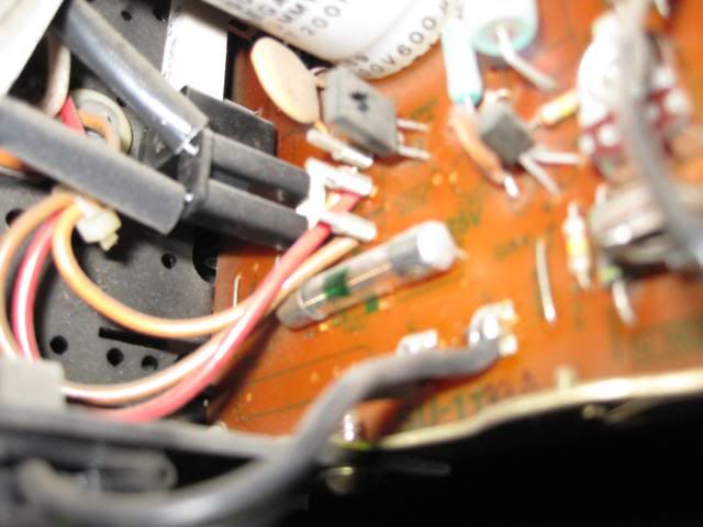

I pulled the filter board, same problem. I started following the G07 flowchart (here) and found that the fuses at F901 and F902 both failed continuity. I then used the diode check setting on the HOT and got a reading of 1.062 V, that means it's ok right?
Where should I go from here besides just rebuilding the whole thing? Is it possible that it really is just a fuse problem?
The stickied monitor thread said it's probably a blown flyback. A visual inspection doesn't show any cracks or leaks though. I guess I'll just shotgun it and replace everything.
Alright, shotgunned the whole thing today. Flyback, caps, HOT, horizontal width coil, regulator, pretty much everything. Still the same problem, no neckglow. I'm starting to think this may have been something stupid like the monitor not getting power the whole time.
