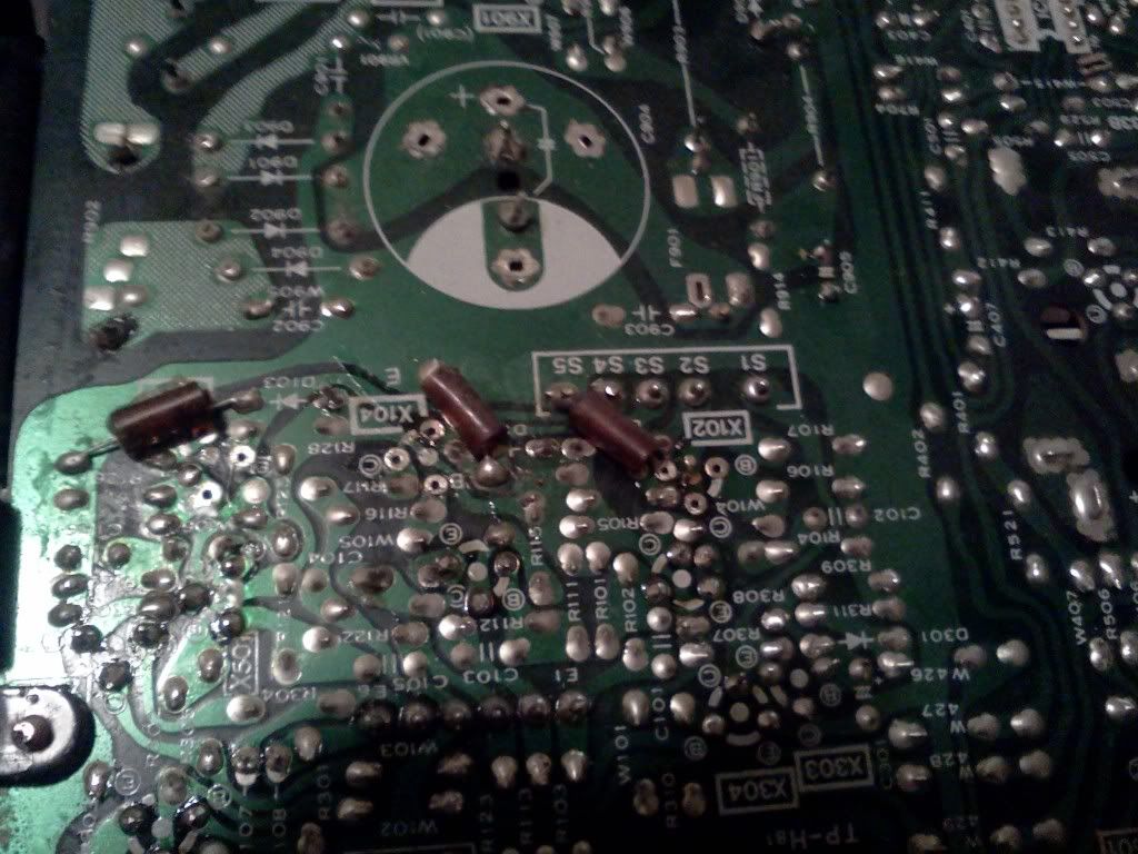

I have this G07 I have been working on. Replaced the Flyback, HOT, VR, new capkit, replaced a few bad diodes, and swapped out IC1. B+ sitting at 119.9V. Can't get past this screen. FWIW, this is with the screen(brightness) most of the way down. Also does this with another CRT as well. The top of the width coil seems to be a bit loose, but still very well intact. Tried to search some G07 repair logs, but there aren't many out there that I can find.

Checked out that area and didn't find much. R308 had an 8K ohm resistor in there where the schematic shows it should be 10K. Also X303 is an A1015 where the schematic shows it should be a 2SA673. There also seems to be some mods on the under side. Don't know if they are factory or done after the fact.
Did you check X303 and X304 to see if they were working?
OK, I replaced X303 and X304, still the same. I pulled X102,04, & 06. Accoring to the matic, they should be A673. But they are actually A1015 in there and seems to be some sort of mod done. Can anyone tell me if this is factory and what the proper transistor I should put in there. Here is the mod.
