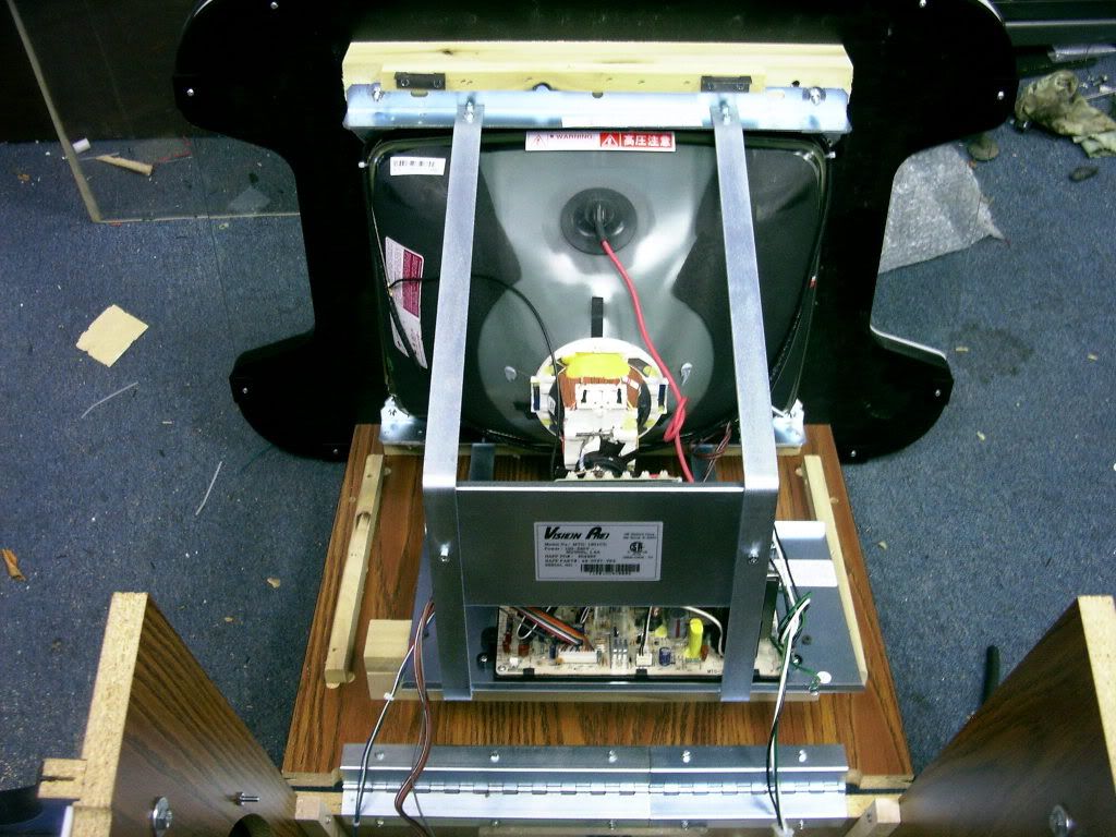

I have a horizontal frame from a HAPP vision pro when I swapped it to the G07 vertical, but the cocktail frame sits a couple of inches into the cab with the 4 frame bolts bolting to it in a recessed fashion, no?

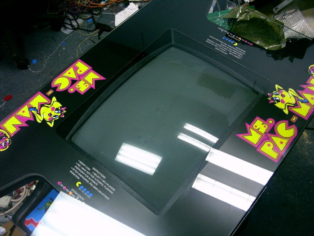

Since you haven't mentioned which cocktail cab you're trying to put this into...
But I'll assume you mean a Pac/Galaga style? yes, it sits a little lower in, with a plastic monitor bezel and tinted plexi above it underneath a glass top.

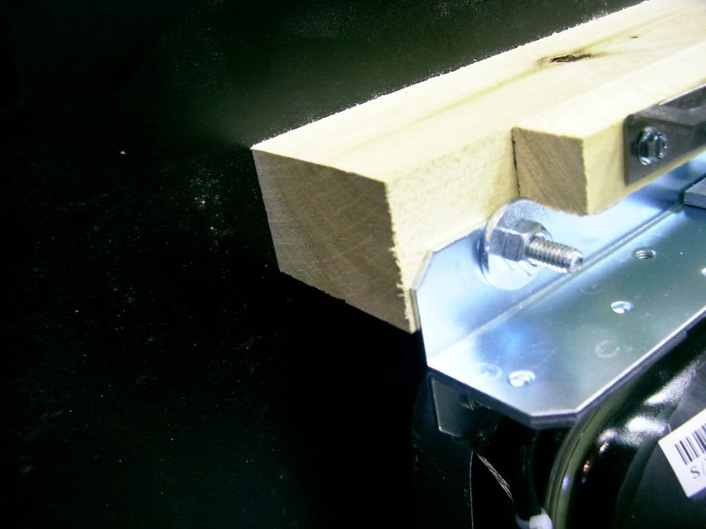

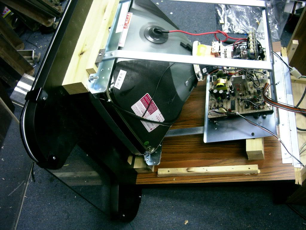

If you don't have that special frame that was made for that purpose, you can make standoffs yourself out of metal brackets or wood bracing. I think the frame mounts needs to stand off about 2-2.5".
Here are a few pics of a universal-mount Vision Pro mounted into a cab using wood standoffs. It's not the same frame, but you should get the idea...

This is good shape "Pinbo" cocktail cab... in my opinion, a rather rare gem... but I could be mistaken.
