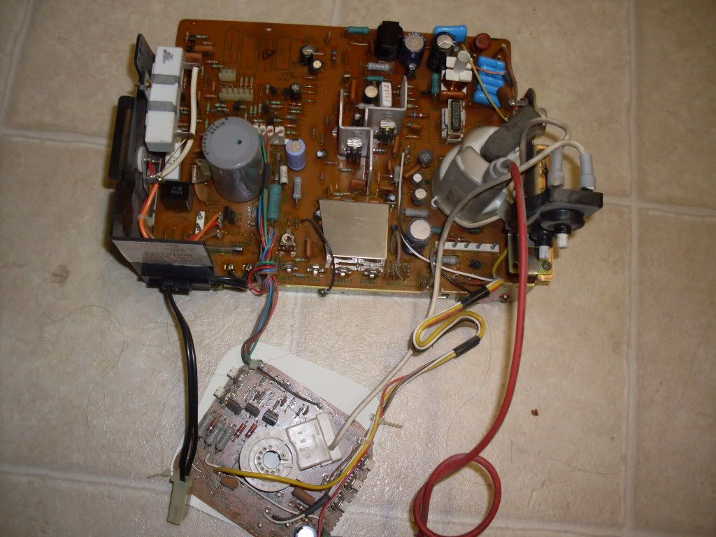

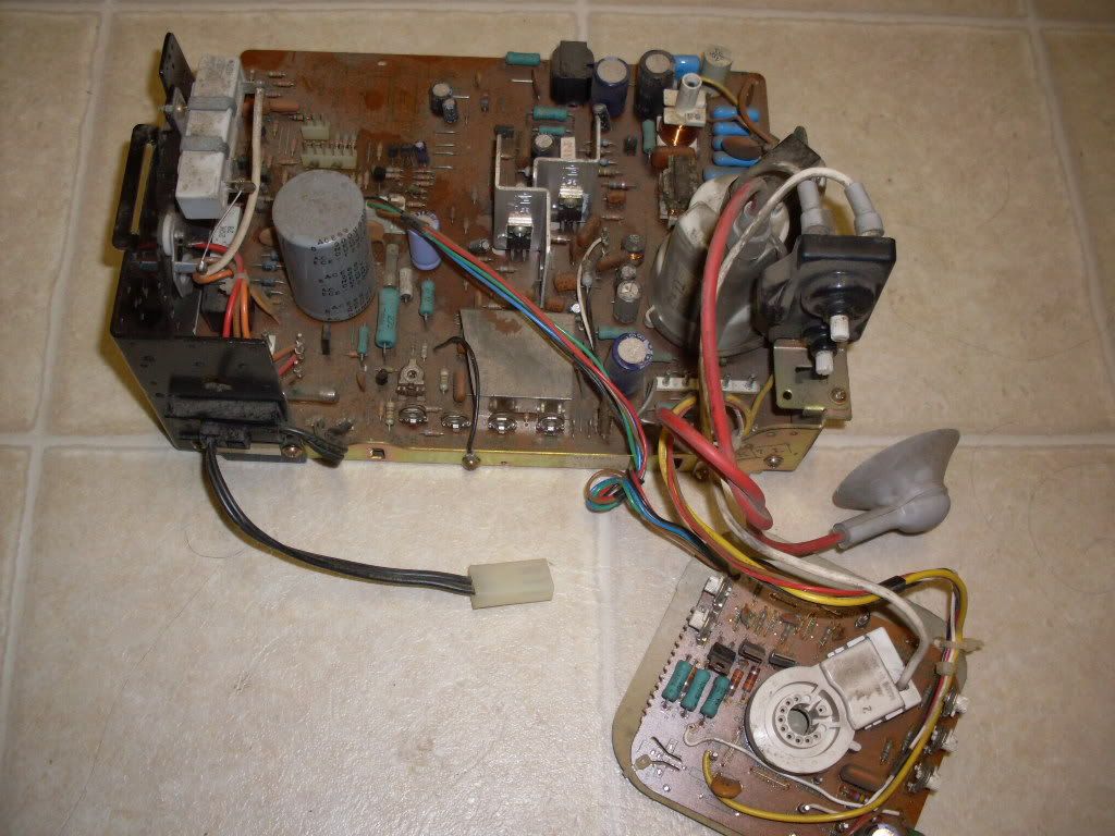

I have two G07's here I'm going to be rebuilding over the next hour. One is dead and one works. The dead one had the small fuse blown and a big spark when I discharged the filter cap.

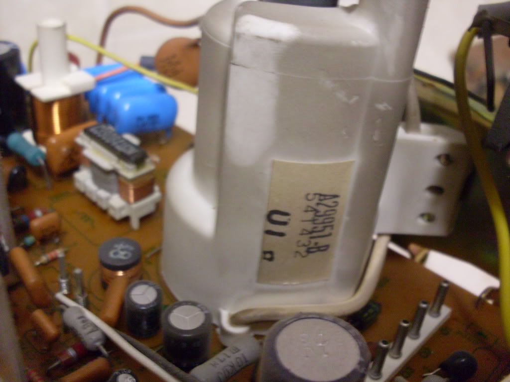

Typically, the original G07 flyback has a label with a green stripe on it. It has been well-established that this flyback should be replaced during a rebuild regardless of whether it is currently working. My dead chassis has this flyback and it will be replaced.
However, my working chassis has a flyback with a different label. It looks all original, and the solder below confirms that the flyback has never been removed.
So, will this flyback also need to be replaced? I know it's normally standard when dealing with an original, but that always has the green stripe. If this is from a different manufacturer, then it may not need to be treated the same. Would rather not waste a new flyback if I don't have to.
Here are the pics:
Dead (and dirty) chassis - manufactured November 1984:
Working (and clean) chassis - manufactured December 1981:
The clean one has an original too. Who knows how long it will last. It could blow up tomorrow or it could last several years.
yeah, that's what I figured. I'll save it as an emergency flyback should I need one fast or for testing, but since I'm being paid for the replacement, I might as well use it and sleep better...
