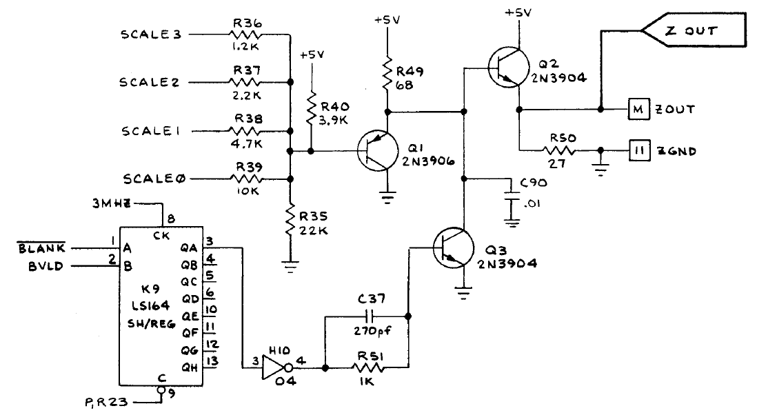

So made some progress on the picture issue tonight, but still have issues. I did a cap kit, re-soldered all the edge connectors, and changed the four bottle caps.
I now got rid of the collapsed screen and have a full screen. However, I still can not get rid of the extra lines, and bright center dot.
Once again brightness pot on the deflection works, but the contrast does nothing. Would the contrast pot be the one to remove the extra lines and bright dot if it worked?

The retrace lines are more controlled by brightness. I wonder if you could potentially have an issue with the Z-output on your game board. Did you have a way to check this board against a known good monitor? (Sorry if you mentioned this, I'm too lazy to go back and check).
If not that, check the pots with a DMM, as well as Q503, Q504, and D506. Also, look for cracked traces and solder joints in that area, as well as any damage to all other parts in that area.
Also check the harness, and make sure there are no broken wires, or broken/bent pins on the tube.
(To clarify, your Z signal is stuck, so there's no blanking of the beam to hide the retrace lines between vectors, so you are seeing all of them. Sorry, I should have said that first.)

Ok this problem sucks, lol. This is where stuff gets out of my league to fix....now with the possibility of issues with the game pcb Z signal and the deflection board, I'm screwed, lol.
Found this info online about Z signals, but it just makes it more daunting of a task to fix
I am convinced it's something with the Z signal too, but where to start? Game pcb or deflection?

From what you read and see, do you think that it is the Z circuit too on the pcb?
Your monitor PCB must be able to adjust both BRIGHTNESS and CONTRAST. If the latter is not working, then you need to replace the POT or figure out what's wrong on the monitor chassis.
For Zout, I would check the wiring. I would scope the signal at the logic board and at the monitor, if you're careful. (or in your case, maybe put DVM on signal and see what the AC and DC values are) ... did I ever mention you should have a scope and learn how to use it? LOL - it's just a fancy DVM that shows waveforms instead of numeric readings ... :001_ssmile:
BTW, Zout is a pretty straight forward circuit (at the output stage). I cannot recall if your PCB had ZOUT issues or it was another I fixed that had all the retrace lines showing. :confused: In any case, your PCB seems to be running code OK.
Also check to see if any other the small transistors are short (with PCB unpowered).
If you have a logic probe, you can check the SCALEx signals, BLANKn etc. :)
Check to see if there are obvious rework done to any of these components.
