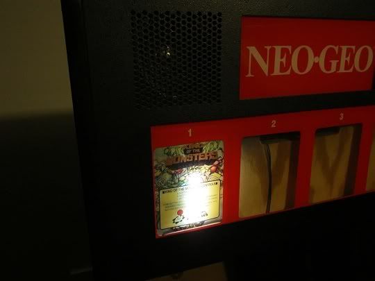

Yes, I have a 4 slot that is missing everything marquee wise. It was all stripped by the op. The harness, light board, inverter, the bracket. It wall all removed and a florescent tube was put in its place.
You're not getting out of it that easy, I can make you a cable :p.
