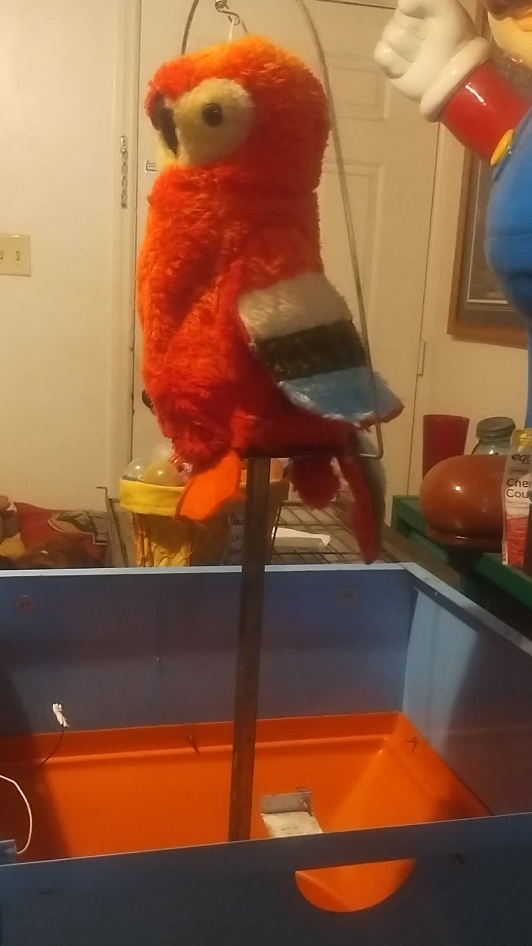

Guess I'm joining the fun chicken club but with Polly the patriot. Found it this morning at flea market.
So I got home and was poking around and opened the back of that patriot who had Velcro holding him closed and inside is this metal bird with wings that look like they move under power and the date and number 46.
