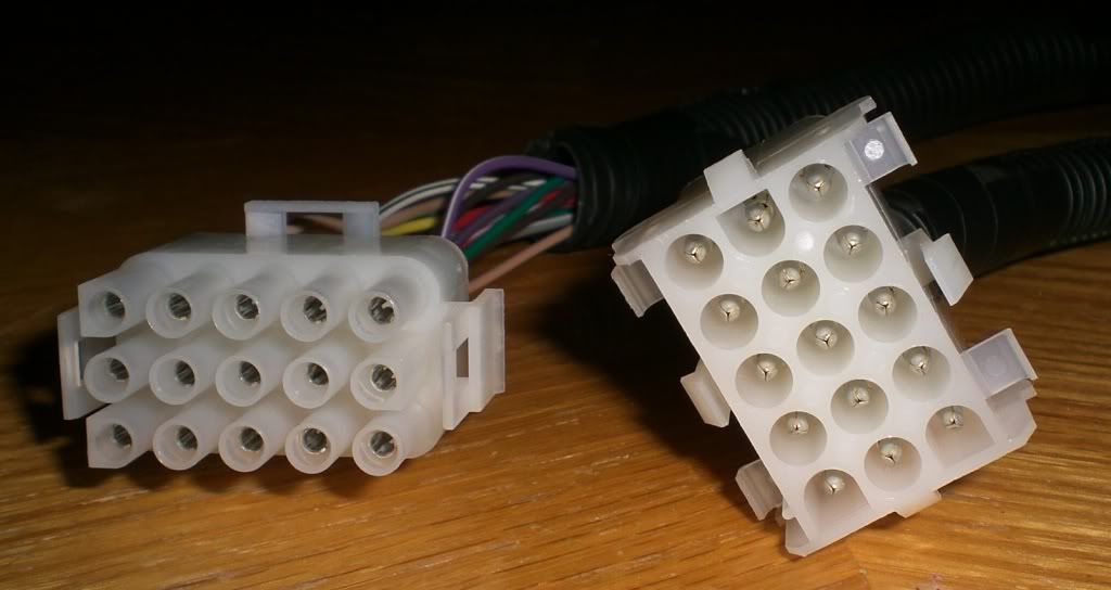

My Star Wars upright has a 6100 in it, and the harness that plugs in the monitor was very tight. I was afraid that the tension in the cable would eventually damage the solder joints on the deflection board. I needed to make an extension cable to get some slack. Plus, I wanted to put my molex plug back into the frame mounted bracket.
Why make 1 when you can make 3, right?
So I have 2 spare extension cables left. These have been hand made by me, using my crimp tool. There's no rhyme or reason to the wire colors - I just used what I had available to me at the time. The harness is wrapped in plastic cable guide I reclaimed from an auto harness. Each one is about 15" in length. More than enough room to relieve the tension on your 6100.
$15 each shipped to you.

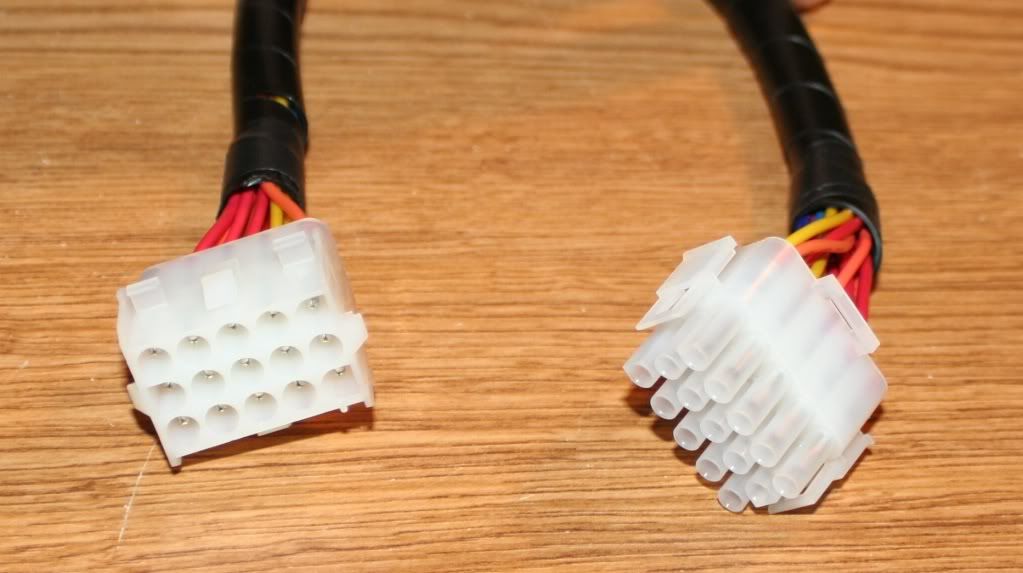

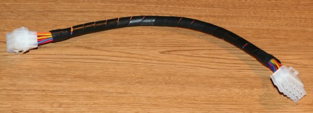

Here's the latest one. Again, no rhyme or reason to the wire colors here, just using what I have available to me. Same goes for the cable managment - it might be side-entry, it might be sprial wrap (like this one) or it could be mesh. It's just whatever I can scab from the junk bins at work.
Each one does get tested for fit and continuity before going out however. I'm getting really good at crimping now, so each one gets better than the last.
