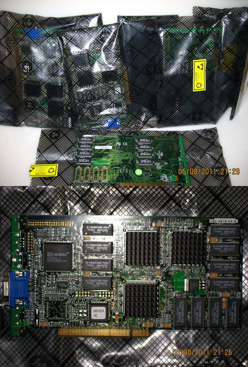

These are brand new never used original. I am glad I was able to get these to save all the games that don't work because of a failed 3dfx card used in the many midway games.
Right now they work in Gauntlet legends and others.
If you need it to work in another game like Hydro Thunder etc, send in your bad card for free security rom swap with purchase of new..
$55 each shipped.
Under the Semiconductors/Parts tab on my website for self checkout now.
This will be a permanent item until all sold.

That's interesting -- there's a security chip on the video card?
San Francisco rush is one entire gameboard.. no offboard video card.
Yes, the security / boot rom # will be the white sticker on your card.
the ones i have are stocked with 546-0014-02.
those work with Gauntlet legends and some others.
You can transplant other # security roms if yours is different on your dead video card.
If your game isn't booting / no action likely it's a bad video card.
As time passes I will start documenting which security roms are needed for which game.

Apparently Gauntlet Legends doesn't care about the ROM though. I put a retail Diamond-branded Voodoo 2 PCI 12 Meg card in my cab and it works flawlessly. Tried an 8 Meg version, and it had graphics glitches, because the original Obsidians had 10 Megs on them, but it booted & played fine, otherwise.
Search for "Gauntlet Legends Video Card Substitutions" on YouTube. I did a 4-part video showing some different cards I tried to use.

If you want to test these on Dark Legacy, War FA, and Tenth Degree let me know, I have the chips you need! hint hint.... (Doesnt work with Blitz/Showtime or NBA on NBC)
