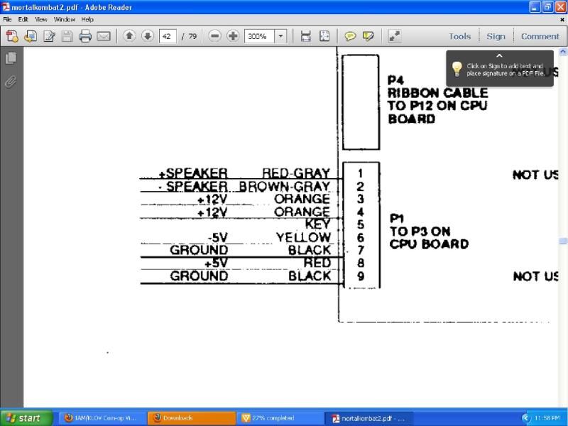

While I've got you, I was also having an error with the sound board. I checked the voltage and made sure I was getting -5V DC to the thing and for some reason the sound board would power on during the rom check, but the light would immediately turn off as soon as it finished. Whenever I'd do a test I would hear 0 beeps, so I assumed this was a power issue and swapped the power supply, but still the same problem. I also made sure the cables were lined up properly so they ARE hooked in properly. Any ideas?
When you say the cable(s), are you talking about the ribbon cable too? Usually the ribbon cable being backwards causes that issue. Of course, it's quite possible that it's simply bad. You can go into the service menu and do the sound checks to see if anything plays.
I made sure the ribbon cable was on there properly, but I WILL take pictures of the ribbon cable attached on each end just to make 100% sure I am not an idiot, but for all I know I probably do have them on there backwards. The sound checks do not play any sounds. The board actually shuts off after the rom check.
Hmm. That's a strange one. If you don't even get the initial "Bong" upon power application, then I'd say you have a voltage issue. Here's the pinout of the power connector...
...see if everything is correct. If it is and the ribbon cable is correct, you may have a bad sound board. Unfortunately, they DO go bad. I have a closet full of them. I have run into, on occasion, that a bad ribbon cable will cause the sound board to be intermittent. My old MK2 cab would have sound one minute, then nothing. I'd reset the cab and nothing. I'd change out the sound board and the sound came back. After cycling power, the sound went away again. Turns out the ribbon cable was bad. I replaced it and never had an issue again.
