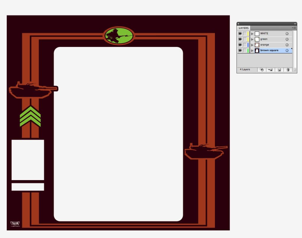

Scan glass, redraw in illustrator, separate colors as layers:

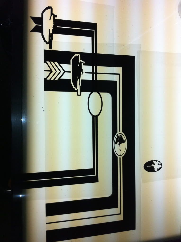

Create film negatives:

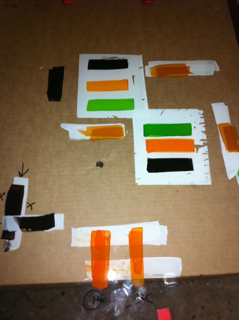

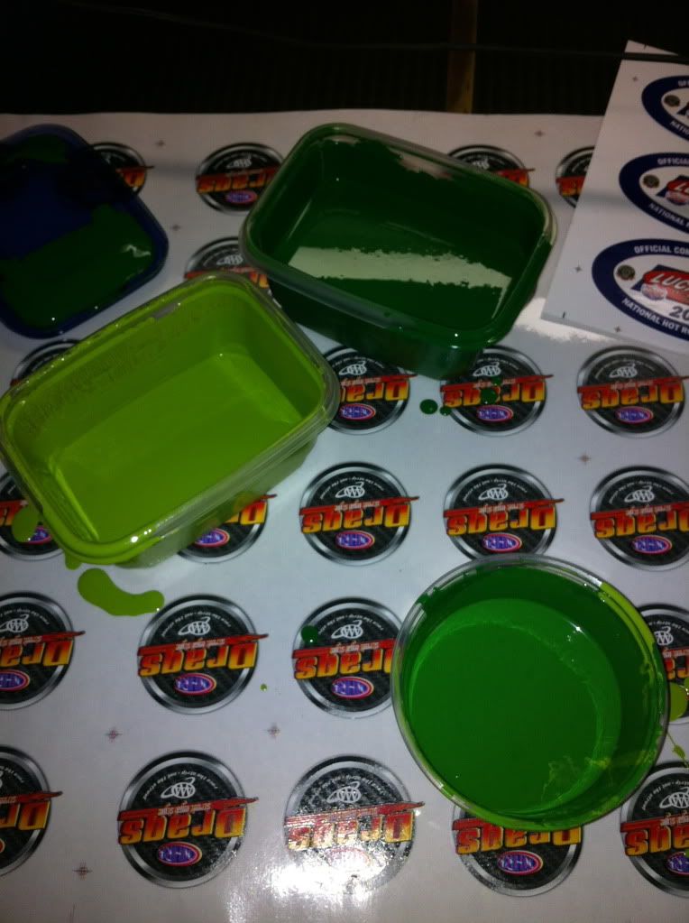

Mix the inks to match colors:
