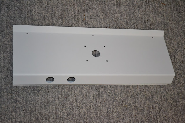

02.24.2012
Sand and scrape the last remaining residue of glue off and get control panel ready for paint. First few light coats of white primer get laid down and left to dry overnight.
Sanded and ready for paint... Top...
Bottom...

Primed control panel front:
