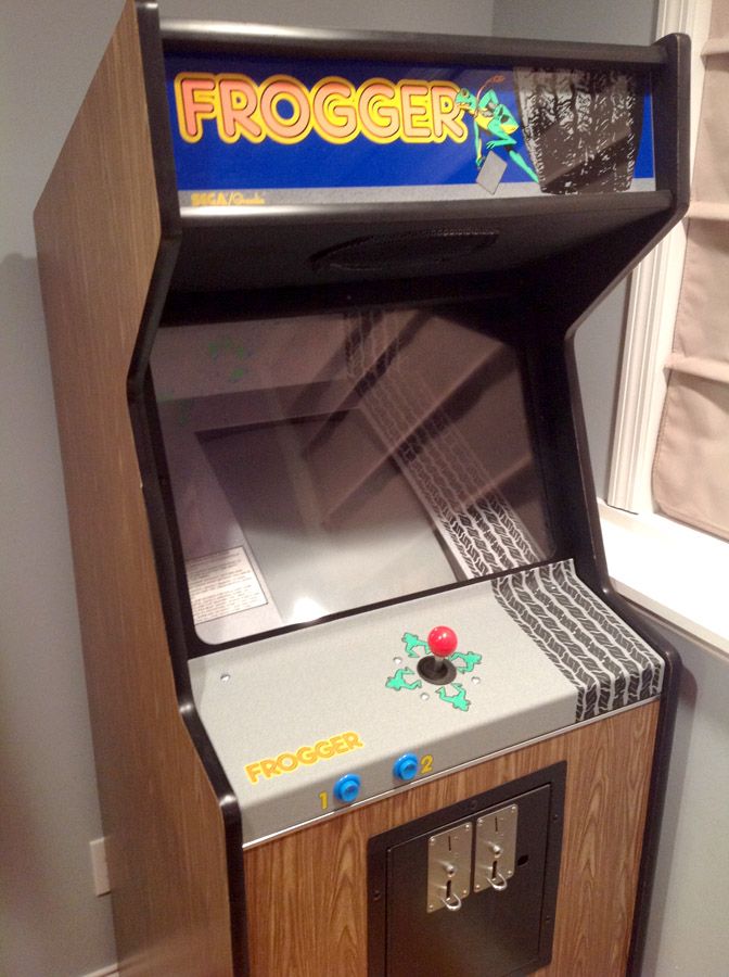

I discovered some AMAZING product called Con-Tact. It is a vinyl woodgrain covering meant for shelves and cabinetry. It has a deep oak color (though the camera sort of washes it out) but it looks identical to Atari cabinets. It is SUPER easy to manage, bubble-resistant, stretchable, and yields AWESOME results.
Here it is roughly laid out before cutting

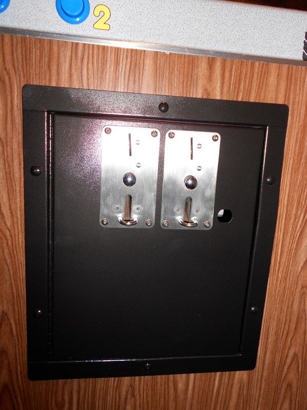

Does anyone know if I should use any extra adhesive other than what is on the Con-tact paper? The wording on the package makes it sound like it is fairly weak.
The black areas are painted and all the dirty work is done so I moved my empty cabinet to the basement since I could move it around by myself empty. :)
OMG - a bright green Frogger - I LOVE IT!
Many of the UK vac'ers would have a heart attack if they saw that. They are such pedants!
I realized I never updated this thread with finished pics. I finished this almost a year ago... Anyways, I went with the Contact paper woodgrain since I couldn't find the "correct" stuff anywhere. I'm holding off on ordering sideart like I planned b/c I wasn't too confident on how long the Contact paper will stick - so far so good.
Still need a couple easy final touches - a lock for the coin door and the monitor needs a cap swapped. Made the mistake of putting the joystick dust washer above the control panel, and I ordered the wrong color blue buttons so I'll replace those with the darker color next time I order parts.
