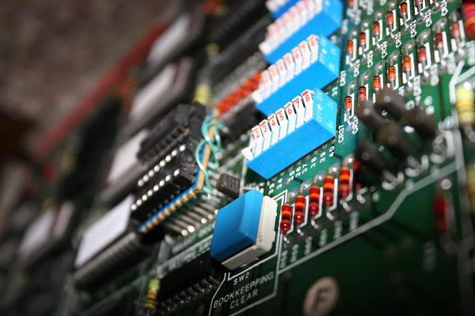

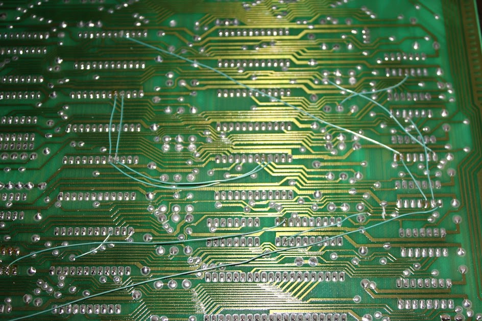

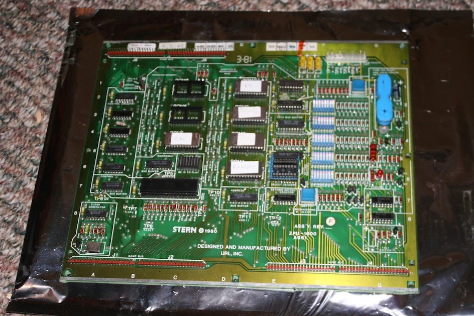

Hey Guys,
I got this gem in the mail today, couldn't believe what I saw and threw it in one of my Berzerk. Imagine my surprise when the ZPU-1000 booted and came up as Stern Frenzy!
Here are some photos of the ZPU-1000. Its been heavily modified but darn if it doesn't work!
I had been told this was possible, but I didn't know it required this much work! I thought it might be a multi-board since all the EPROMs are 2732 not 2716 but it appears to just be Frenzy.
Still an amazing board to have!
Thanks
Disjaukifa
The Frenzy I had was a Berzerk conversion, which was a ZPU-1000 with a small carrier board on top. IIRC there's a document talking about how to duplicate that board, but it looks like whoever hacked that board just permanently wired it like that.

I found a document that tells you how to build a switcher board for the ZPU-1000 but I didn't know you could just hardwire Frenzy to it!
