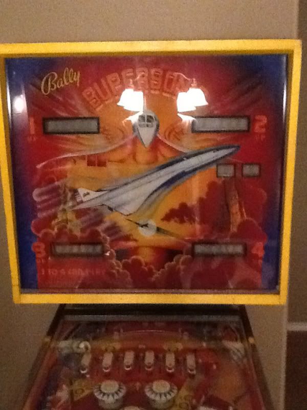

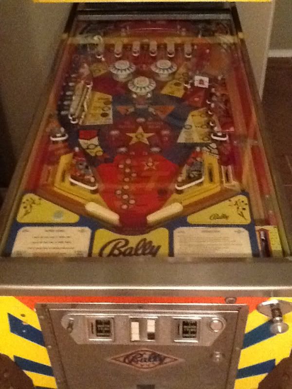

Looks pretty damn nice. I just sold one of these to a fellow KLOV'er. That center area right above the flippers is a huge wear spot waiting to happen for most machines, so getting one with it intact is a win. Looks like your backglass is lifting...mine was too. Previous owner taped part of it (UGH) and triple-thick'ed the rest.

Yeah, I was super stoked when he said I could have it for free. The play field has little wear (compared to it's age). There are a couple of spot that are lifting off the back glass, but not too noticeable. Nice Pinot find ($200 for pinbot is just as good as a free supersonic).
Yeah, the wear is so common on those, they've made decals to replace basically the whole middle of the playfield, including the star area and the SST area. Crazy.
