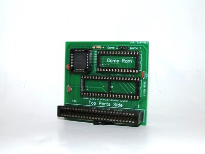

If you really want to use the Two Bits Rom, you can just buy this PCB off of ebay. The rom works fine with it:
Funny... when I made them in 2020, they were only $25.

BTW, a quote from Dokert, not sure if true or false but seems reasonable:
"The Two-Bits diagnostic module, bypasses all ROMs in row 6 as stated above. Usually when the diagnostic module is left in place with the Game ROM installed, there is a problem on the board. You would need the Diagnostic ROM to tell for sure.
You can also change the game to a standard Pacman by simply swapping out the character ROMs 5E & 5F if I remember correctly."
Speaking to just the diagnostics portion of the kit, I used it heavily 16-17 years ago to test/diagnose a number of Pac-Man and Ms. Pac-Man boards. For this function, it helped and was good for the quick diagnostic. For complicated repairs, it was not as useful.
Of course, I also used a bootleg aux PCB that included the row 5 ROMs to further test, since it helped root out other issues.
Scott C.
I have a new version of this that will be ready soon, i have tested it with header instead of ribbon and it slides under the daughter board.
added a header instead of cutting jumper for pac/ms.
will update when fully tested.
