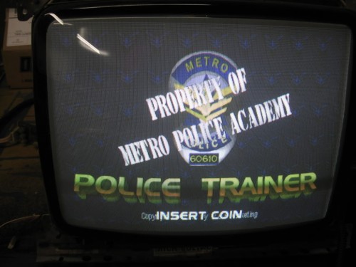

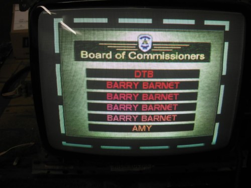

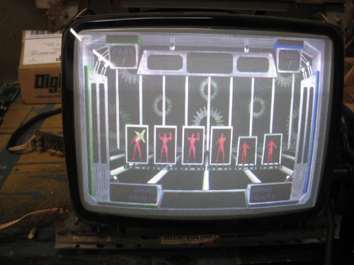

So, I decided to hook up a JAMMA board to this monitor to see what I could see.
I had a Police Trainer sitting on the shelf:
Perfect picture. Well, I guess that settles that. This monitor looks better with standard video.
WTF? I really don't want to have to 'un-do' the inversion circuitry on the board to revert this monitor back to inverted video, but I can't really use it with an inverter board. I'm kind of stuck.
