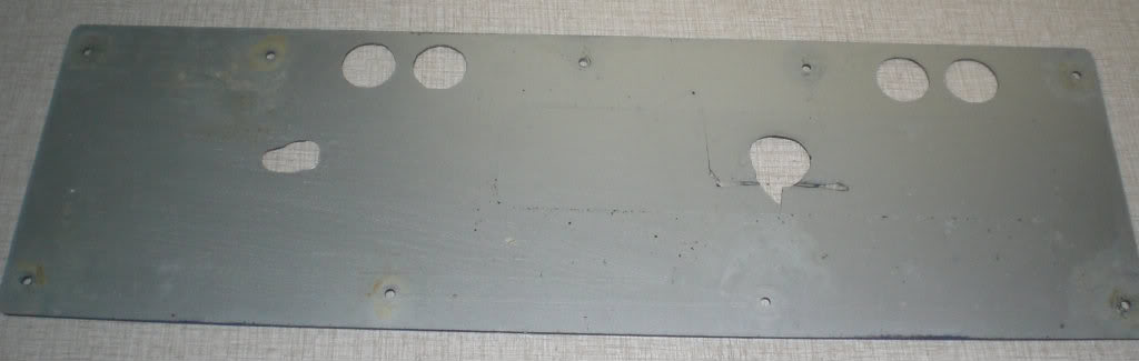

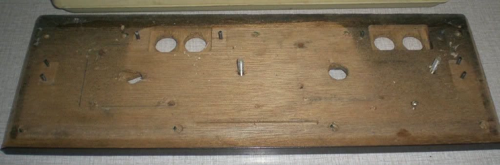

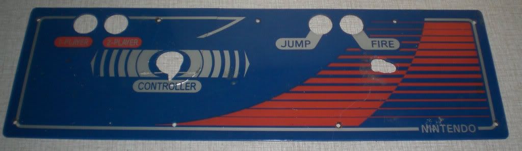

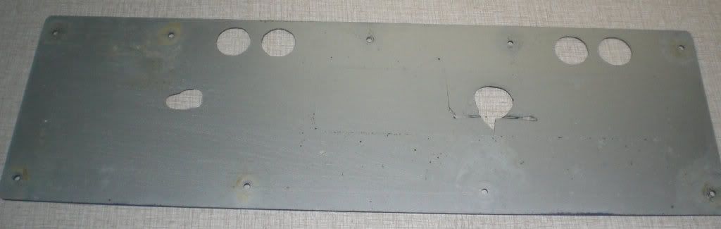

Here's a few shots I took when I tore down the control panel this morning. The CPO had been hacked in the past to add a 2nd joystick, but that's the least of my worries. I'm more concerned about the fact that it's cracked all over. It's going to need to be replaced. Anyone like to volunteer to vector it for me if I get a high resolution scan?

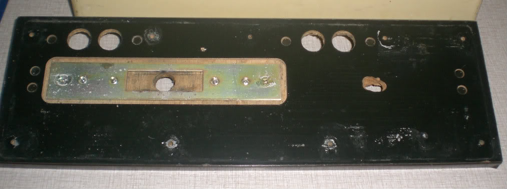

Here's some shots of the control panel, stripped. There's a large bracket screwed into this panel, presumably to mount the 2 way joystick to? If anyone has any idea why type of joystick belongs on this mount, please put up some pics. Otherwise I will probably scrap this panel and re-create another that I can mount a regular ol' Ninty joystick to.

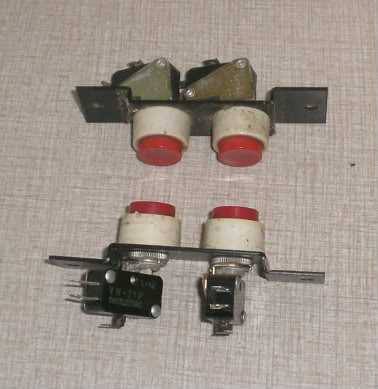

Lastly. the button assemblies. I'll work on cleaning these up.
Is that CPO aluminum or plexi??? What Shawn didn't vectorize that CPO for you as payment for letting him borrow it?
I would think that the cabinet had a standard Nintendo Joystick with the 2 way restrictor plate:
http://www.mikesarcade.com/cgi-bin/store.pl?sku=TMA-11-17
But that metal plate looks nothing like the mounting plate for a standard Nintendo stick. Maybe Todd would be nice enough to snap a photo of the underside of his panel?
Shawn might be able to vector the marquee for me - I've asked him. As far as the CPO goes, I believe he's already got something pretty close that he used for his DK JR cpo - I'll just ask if he'll let me use it with new colors.
The CPO is plex, but it has a layer of aluminum paint on the backside. I'm guessing this is to make the colors stand out better, but Rich will probably chime in on this with more expertise than I.

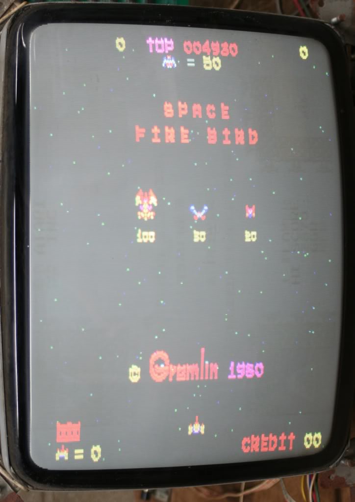

I decided to go the easy route first, and use the inverter board method. It works, but I'm none too pleased with the results. It appears that the red is being over driven. I can't adjust it out with neckboard, chassis, or inverter board controls.
Now what? Go back and de-convert the monitor?
Before I dive into the chassis again, I think I'll try it on a DK board to see how it looks.
This project is back on my radar again - I'm still wondering what I should do with this monitor - it's got Warlords burn-in, so I'm pretty sure this little Sanyo monitor came from the factory with the inversion circuit already converted to standard video for use with Warlords. Somewhere in its life, it was pulled out of a Warlords cocktail and put into this cab.
I SHOULD test it with a standard video game, like my bench rig (Tetris) to see if the colors look any better with just the monitor and NOT using the inverter.
I could also test the monitor with my DK boards to see how it looks with those.
I'm afraid that the inversion board is making the video look crappy. If that's the case, it's just another road block to this cabinet restore.
