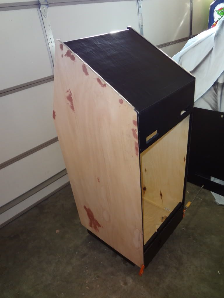

My Missile Command cabaret project is a do-over because of this. I made the sides out of 3/4" birch ply, then used a thin grade wood grain laminate on them. Not only did it pop up around the edges, and I do think I used enough adhesive and applied it correctly, but it kinda bubbled in areas, as if the laminate got bigger in spots like there's air trapped in a bubble, if that makes sense. One side peeled off pretty easily.
I learned a LOT in the process, so I am not too pissed and don't consider it time wasted.
I'll rebuild it this winter with particle board panels. I have a swollen/crappy BZ cabaret cabinet that I'd like to do at the same time. Too little money and time.
Hey guys, I did formica on plywood back in June. It is holding up fine, I used rubber cement and a J roller to apply it. Granted plywood does shrink and contract more than particle board, I fucking hate particle board.
So here it is October and the formica is just fine on the cabinet.
I used plywood in my mini DKjr build, but I painted it and then covered it in vinyl, which is flexible. Other than some wood grain showing thru if you look in the right light, vinyl-covered plywood worked well in this instance.

I vinyl covered some primed/painted/sanded plywood panels on the doomed MC cabaret project - the back pieces, top - and they turned out great and held up fine. It's just the laminate on plywood that failed in my case.

Then just use 2 layers of white vinyl over plywood next time. Or just laminate particle board as you mentioned.

I'll be using particle board in my Atari cabinet rebuilds. As a material, I think it sucks, but.. as a substrate for laminates, it seems to be the one to use. I will at least seal all edges with a primer or sanding sealer to prevent moisture infiltration, and in a HUO environment, it should be no concern.

While Formica and the laminate stuff I read may advise against it, Atari actually used standard grade (the thicker stuff) laminate on the front of some cabinets, on top of plywood. My MC cabaret donor is like that. I have used laminate on the front of my failed MC cabaret cabinet (that wasn't the issue), front of 720 with no apparent issues.
The thin/vertical grade stuff on plywood had mucho bubble/separation, lifting, and adhesive failure on the MC cabaret sides and I think there's a tiny bit of separation at the edges on my Frogger front panel I remade (also 3/4" birch with thin woodgrain laminate). I suspect that laminate may not have been the best either, or perhaps I should have lightly sanded the backside to promote adhesion.
Or...maybe my plywood had a higher moisture content and shrunk over time.

Not saying you can't, just that the info says that it should hold to PB better. Look, I think by itself, pb is a crap material, but it apparently is good for more than cheap underlayment. My dilemma was, for building a replica/replacement Atari cabinet - laminate on plywood or pb as original. Turns out, pb is a good choice, not only when it's OEM material, but also because there's less issues with dimensional stability and bonding to the substrate.
That said, if I was building a Midway cocktail where plywood was used originally, I would use it. Also, I used laminate on plywood for my 720 front.
