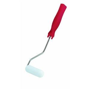

What drove me nuts last night, I was painting the Virtual Boy cabinet and a a few little bits of the foam roller broke off in the paint! I was able to pick them out with tweezers and run the roller over it again.
The roller was a foam shur-line I got at WalMart, what roller brand do you use? Does this happen to you?
