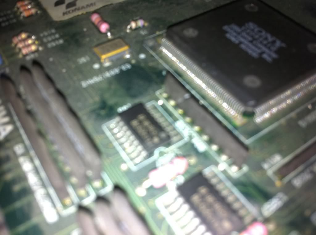

Everything seems to be working great now, however I did notice something else that is damaged. What is this and where can I get replacements?
The skinny black thing by the CPU?
The game is working even with this part being cracked.
