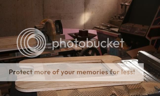

I am preparing to build a reproduction MsPacman cocktail cabinet, and not having access to a sample cab I am unsure about a few details.
Can anyone help with a few photos and a few measurements ?

I've done the same project but adapted the original design to accept new parts like a fan cooled power supply that also handled the on/off switch.
As for the speaker grills- one speaker, I like to mount it in the lower hole so it's away from the monitor (using a shielded version, but taking the pants + suspenders approach).
The other two false grills are for ventilation.
The bigger challenge is going to be mounting the monitor, have you worked that out?
Here's a couple pics of mine in process.
