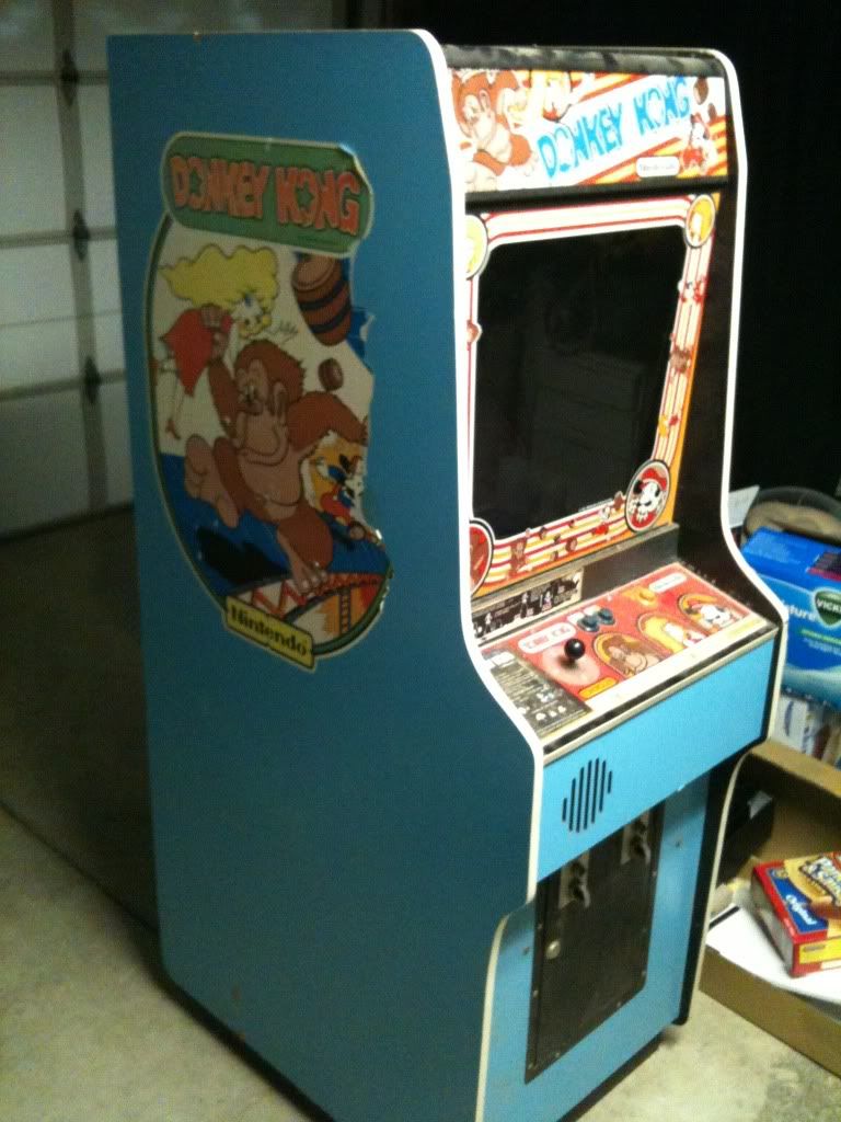

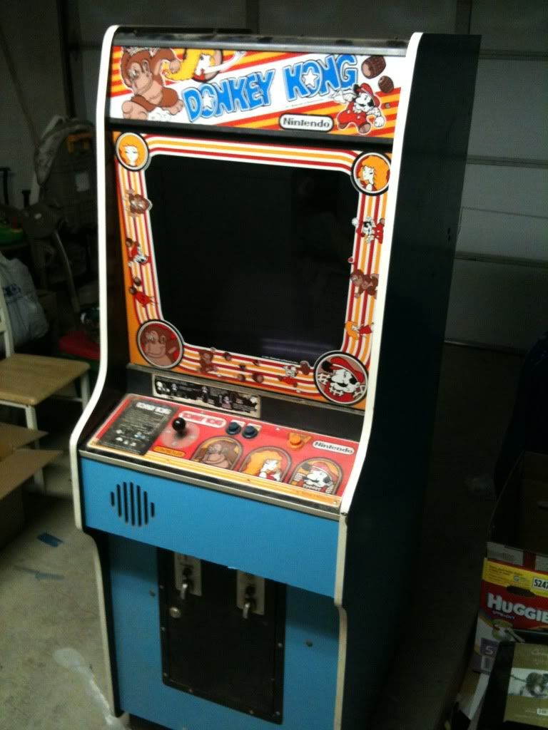

Picked up this little gem this afternoon...
Im pumped to have a Ninty back in the lineup!
Its not working all the way right now, but I think the PCB is hooked up wrong? The PCB has the rainbow cable, but there is also a connector that goes from the PS (I think its marked P10) to the backside of the PCB (marked P10). I don't think you need both? If I need to hook that connector up somewhere else, let me know. I feel like its not right though, and may be the reason its not working.
Anywho, she should clean up nicely. The cab is dirty but is solid with only minor dings. Obviously it needs new sideart and a new CPO, but I want to focus on getting this bitch working before I worry about anything else.
Soon I will be William Mitchell...
Painted black on one side and not the other is odd!
Great score anyhow.
