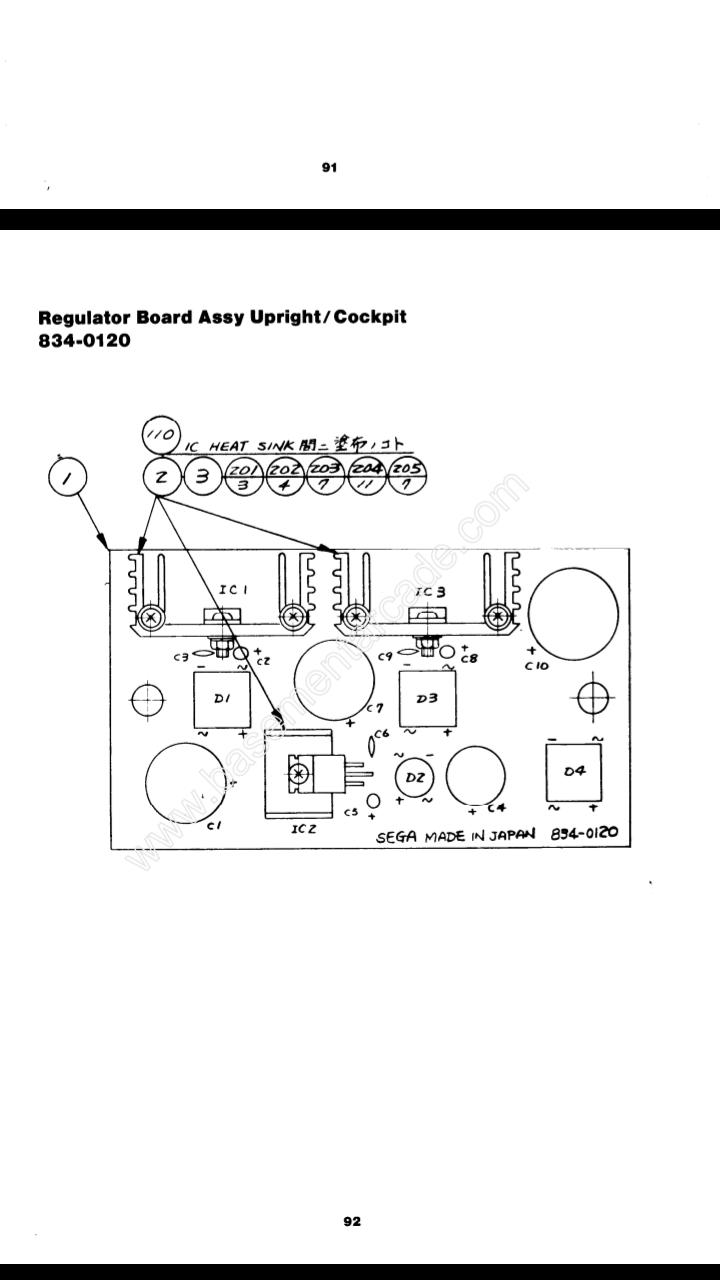

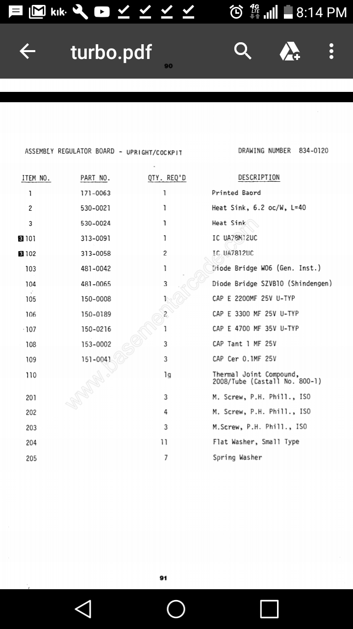

Hey you recapped the 834-0120 power board.
Their all radial caps right? Leads on one side of the can?
No clue never seen it
I haven't gotten to that yet, I haven't replaced any of the caps yet. I need to recap that, the audio amp and the monitor at some point. Looking at it though I'm not seeing anything on it other than radial caps and the little chiclet ones that seem to rarely go bad. I know that one of the guys who posted here. I think either whitefox or offset got a cap kit for it made up by either Ian Kellog or some one else. I can't find that info at the moment, but I need to figure that out myself as well! If you track that down before me, please share! I'm trying to rush to get this to a point where I can get it out of the garage and into the basement before it gets to cold, so I'm prioritizing my task list based on that. One of the reasons I bought this particular game was I know that the electronics had been gone though at some point in the last 10-15 years. The PCB has an eldorodo games tag on it. I'm kinda hoping that it won't need more than caps and cleaning/reseating roms.
