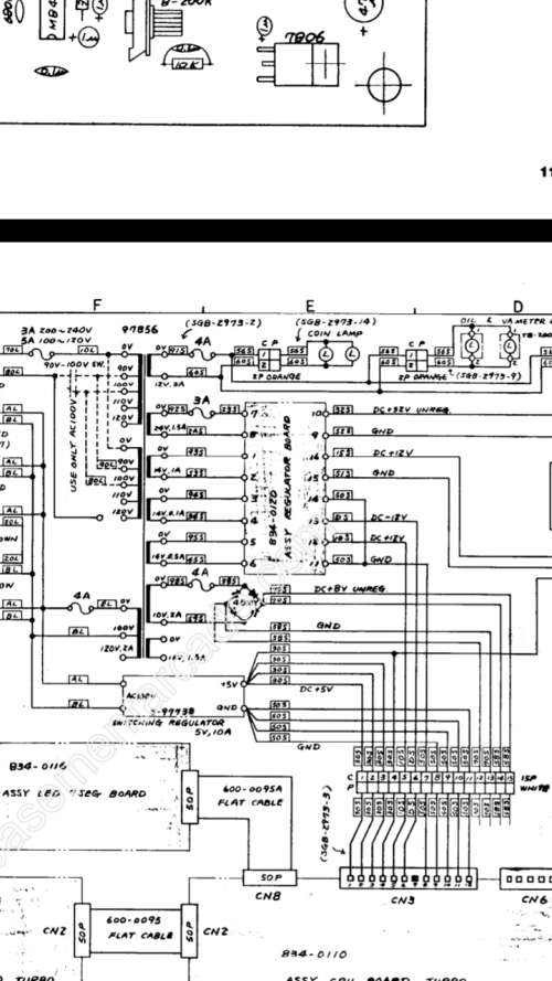

can you explain the switcher requirements please.
Is it using 12 +5 and -5?
my buddys game had the switcher removed and I do not know where the bundles of wires that are soldered to the u connector go.... I think there was pink blue white and yellow?? A photo would help so much thanks
Edit
Ok hust read the manual.... Thr switcher is 5v rated @10amps? Thats it... Just a 5v switcher?
So the regulator board is the magic section 100v in and outputs +12 +12 -12 and 32v unregulated
But there is also what a bridge rectifier seperated for 8v unregulated with a 4amp fuse before it

Ok I understand that now.
But strange the schematic does not show -5v coming from the switcher
Also I see a cap kit on ians site for turbo i assume thats for the power regulator pcb 834-0120?

Check your wiring on the black switcher. Looks like you have the ground wires hooked to the -5 lug on the switcher.
Check the manual before you change anything, but I don't see a ground connection (on your switcher wiring), and I don't recall that game using -5 from the switcher.

Thats what I thought as the schematic only shows +5v and (gnd) coming from the opposite side on the switcher...

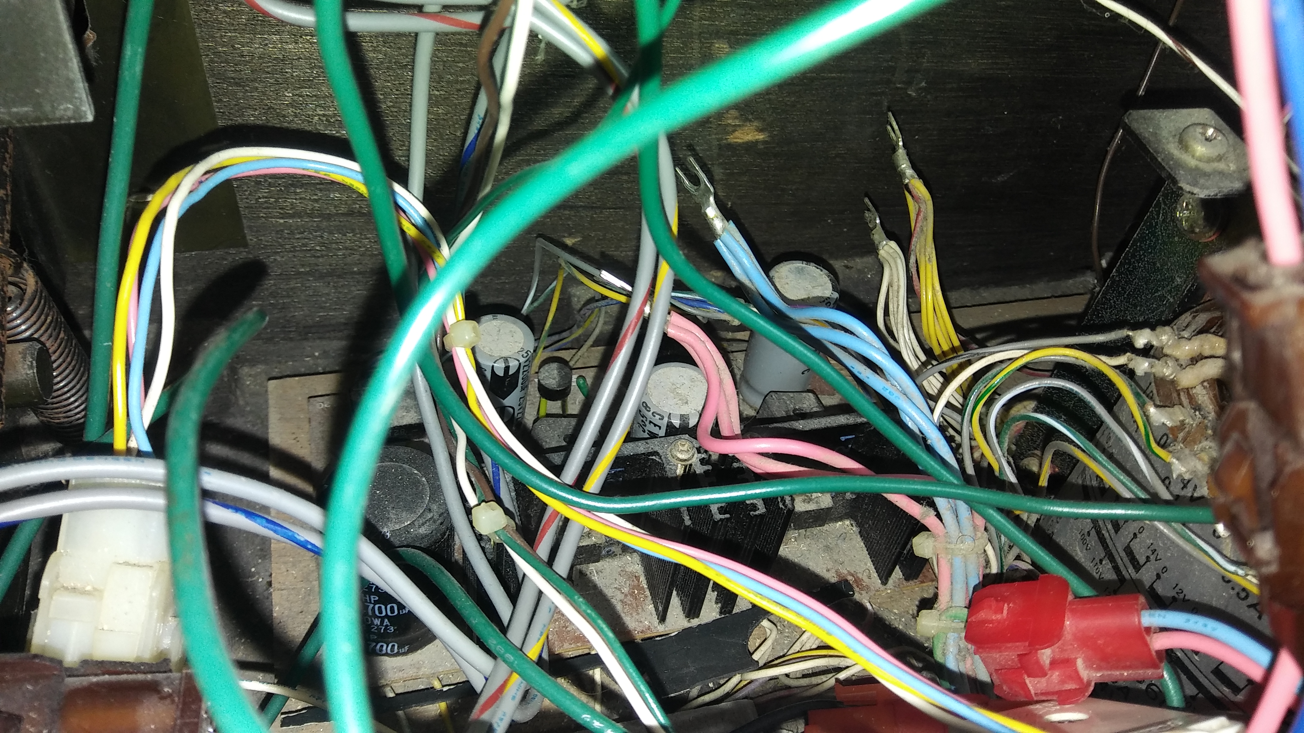

This is my buddies game... A rats nest of wires will work on that next time.
Large img link: https://klovimg.com/images/2017/11/09/20171107_145940.jpg

Is this the general consensus??? It lines up with the schematic... No -5v used.
Also the lights i think I saw 14V ac from transformer to that... Correct me?

Pink power in
Blue power in
Yellow +5v
White 1 or teo bundles on a flat spade connector ->Ground wires
There are one bundles of white wires one white solid and one white and yellow? These are ground not -5v. So I believe...

Yeah I don't think it has a -5v at all. The solid white wires are for ground and the you have a white with brown stripe for the 14v lights and then a white and yellow stripe which I am assuming are for 5 volts or 5 ground as the light in the start button has a white and yellow which is going to the 6volt lamp in it. Sorry I can't be of more help as I'm not quite that far into the voltage wiring yet.

So to recap this game uses +32v, +14v, +12V, +8v, +5v, -12V correct? Where is that 32 and 8 going?
Edit: oh and 100v for the monitor.
