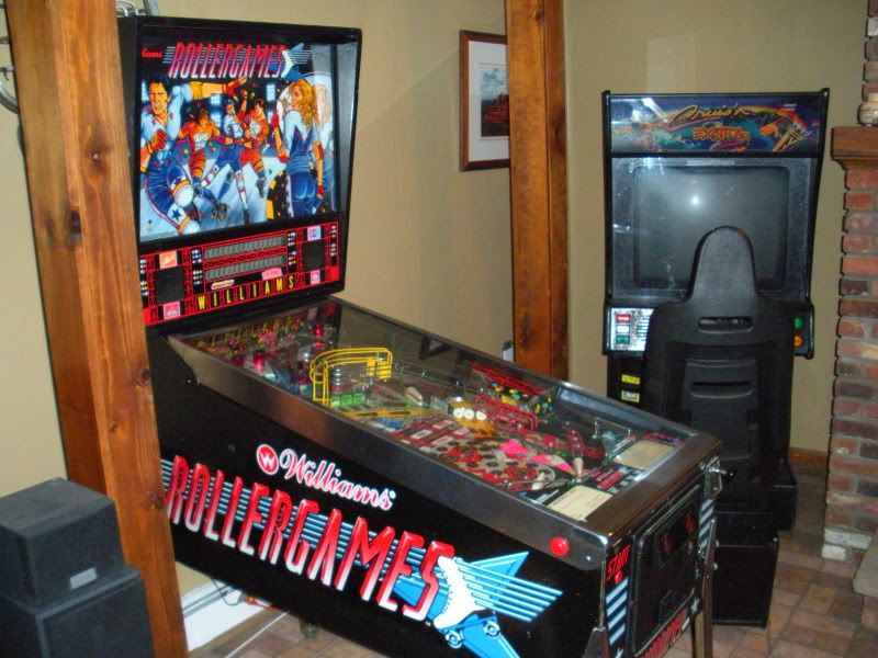

So I finally picked up my first pin today from a fellow klover. I had been looking for a pin that was 100% working since I have VERY LIMITED skills in fixing / diagnosing issues.
When I get there one of the "pop" bumpers was not working and a couple lights on playfield and marquee. Lights arent a problem but the bumper would be. It gets "jerry rigged" and sorta owrking before I leave so I take it home.
Now I have flipper issue and 2 non working pop bumpers + 2 of the lights on the pop bumpers are out and possibly some sound issues. Seems like its missing some sounds.
Here it is next to a cruisin exotica.

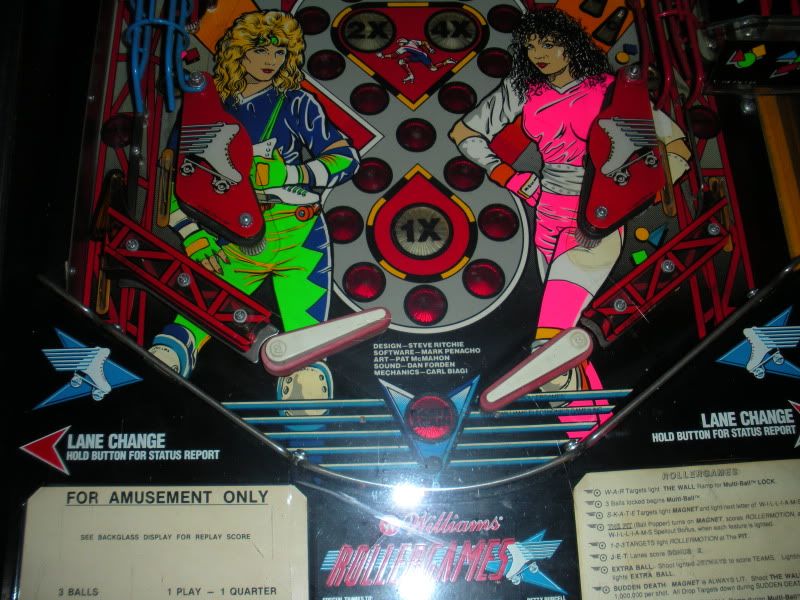

And with f%*^*$( flipper

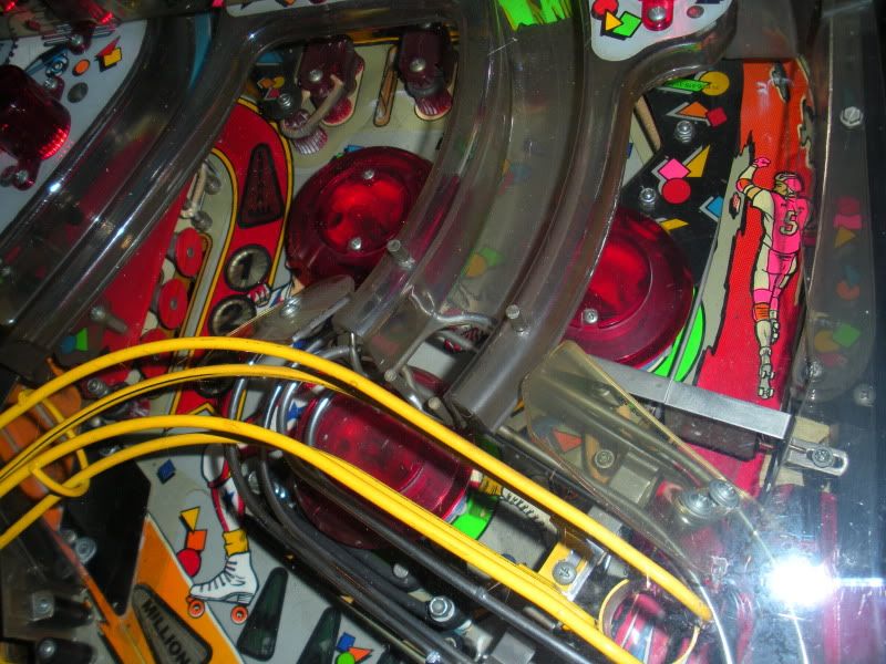

Oh yea and these two up top dont work or light up

Looks like too me your flipper spring is stuck. I would check that first . Sometimes that all you need is getting that unstuck and your flipper works fine again!

Pop bumpers not working is probably misadjusted switches, flipper sticking up is probably something out of alignment... kind of shitty all that popped up as soon as you got it home, but it happens. There's probably 50 switches, a dozen coils, 30 transistors, 70-80 diodes, 100 lightbulbs, etc. with all that stuff moving and having things beat against it, you pretty much have to constantly adjust stuff, replace bulbs, fix this, etc.

The flipper, as someone mentioned, could just be a spring that is stuck. That happens on my Black Knight all the time.
For the pop bumpers, see if they work in the solenoid test. If so, it is probably a switch issue. At least that way you will know if the coils are good or not.

You may be able to free up the flipper by just lifting the play field and cycling the coil from below. My first "real" repair was replacing a seized bumper coil that also created other issues since stuff is looped. Unless you already have an electronics background, you are going to feel frustrated and lost as you learn. There has been more than one occasion in my short time with pins where I was about to say "screw it" and go back to just having vids.

Pop Bumper could just be stuck switch like mentioned above. Or just not properly adjusted. Lights out are probably just bad sockets. Just touch the bulb and see if it lights up.
Flipper stuck could be a number of things but more than likely just a stuck spring, also mentioned above. Open it up and see.
