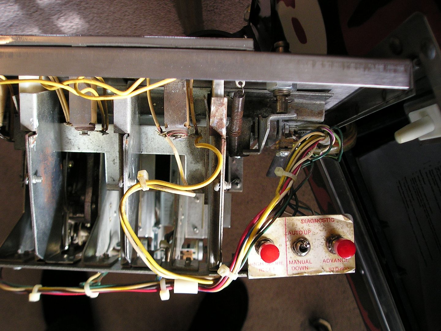

Where is the Auto-Up/Manual Down switch? Inside the coin door?
Where is the Advance button?
Wow I guess that's two stupid questions. I'm on a roll.
open the coin door and you'll see 3 buttons. far right is advance. middle is auto-up- when down it makes advance count backwards.
you'll need manual to know all the functions.

Hrm. I thought the "auto up manual down" switches were supposed to be pushbuttons that lock in place when you push them in the down position, then raise up and stay up when you push them again..
BUT...
My space shuttle has a flip switch like the one shown on that picture as well, lol. Pretty sure it's not wired right, as last time I checked, couldn't move backwards through the tests...
My pics are on my Gorgar, which came out about the time Black Knight did I believe. It's been around, so it may not be original!
Yeah, I was planning on replacing the bank of switches on my Shuttle with what seems to be appropriate, but I'd just be happy if I can get the switch working for the reverse side too. Doesn't really MATTER as long as it works, unlike some other things in pinball, lol.
