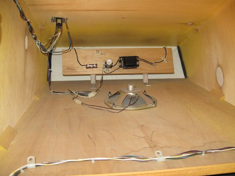

Frizz, the 'eye' is a patch that manufacturers put in plywood when a knot hole is visible.

...and why in the heck would someone put an EYE in to the top?
From Wikipedia - http://en.wikipedia.org/wiki/Plywood:
"A": Highest grade quality available. Can be defect free or contain small knots, providing they are replaced with wooden plugs (the fillers having a "boat" or an "American football" shape) or repaired with synthetic patch. This grade may contain occasional surface splits that are repaired with synthetic filler. The surface is always sanded and provides for smooth paintable face quality.
