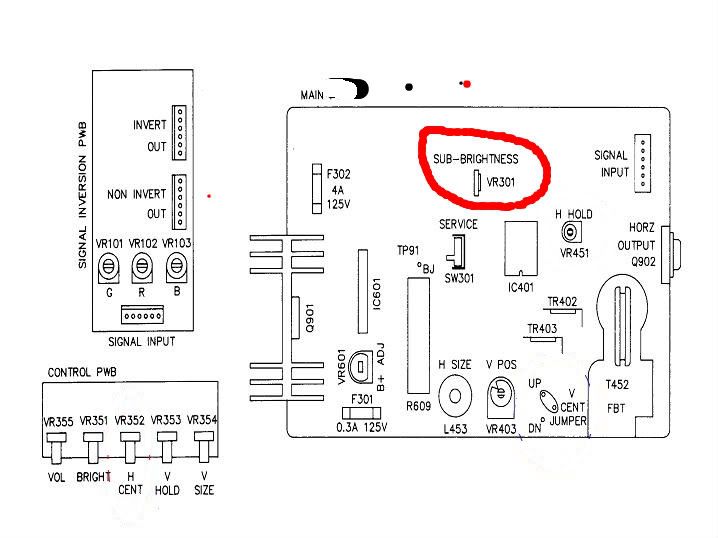

That is the brightness pot, the sub-brightness pot is on the chassis over by the h hold toward the upper right as you are looking at it.
Should one be used more than the other, or is it just if one doesn't change the brightness enough you use the other one too?
You have 3 brightness controls
Master brightness on the flyback
Sub-brightness on the chassis
Brightness on the remote board
Think of them as... coarse, medium, fine.
Center the brightness, and adjust the sub-brightness. If you have to turn the sub-brightness more than half way in either direction, center it and adjust the master brightness on the fly.
