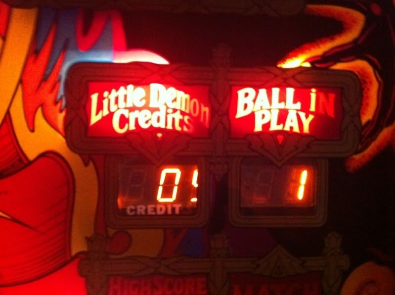

Anyone know how to fix the 'little Demon Credits' display from being off center? It's a 7 digit display and I have no room to move it to the side. Is there a way to shift the digits over to the left 1?
I guess if you really wanted to, you could cut and jump a few traces on the circuit board.
but there has to be a physical reason it doesn't fit right.
It's off because it's not the correct display for the credit/match area. These series of games use 7 digit displays for players 1 - 4, and a 6 digit display for the credit/match. That's why it's not lining up.
Thanks, looking for a 6 digit display now.
