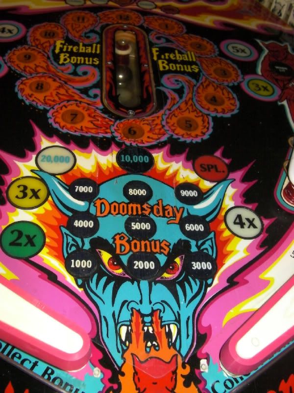

I've been getting the playfield in order while I hope and pray someone here comes up with a new avenue of attack...
EDIT: Playfield touched up... (model paint FTW!)
