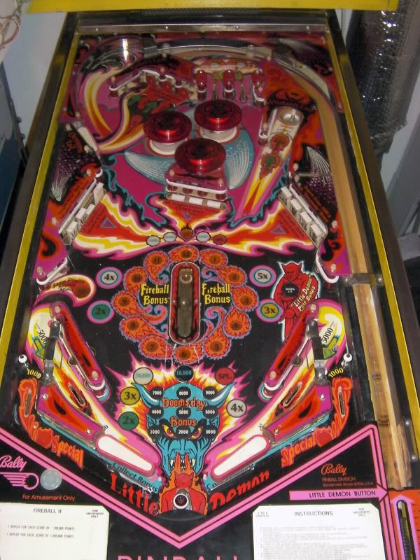

Overall the playfield on the FB2 is in decent shape... I think it will clean up well. There IS one problem area that I am looking for advice on though...
Here is the playfield as it appears today when I got her home...

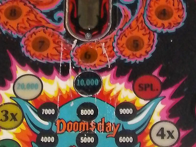

Here is a detail of the problem area... which is unfortunately right in the middle of the playfield directly below the trapped ball under the playfield...
What you are looking at is a rectangle area where someone has removed the factory mylar. I am not sure why... I can only guess that there was some insert issues or something. Anyway... where the mylar is missing the paint is starting to wear. There is also a slight effect to slow moving balls in the area as well...
How do I deal with such an issue? I was THINKING about cleaning it up nicely... sticking some of my own mylar on and using a sharp blade to match the "cut" of the original cut... suggestions? Opinions?

Commenting on the pf damage. You're screwed buddy. That damage needs to be touched up and then clear coated other wise you run a great risk of having the paint chip off again. Or ..... you can live with it.
As far as ball travel issues in that area, Yes you could mylar over it again for sure. Ensure the inserts are flush with the table and if not pound em flush.
If I dropped some mylar over it...it shouldn't get worse... or if I touch it up myself and then mylar it it should be OK... right?
I just wonder about my idea of sticking some mylar on then using a sharp blade to try to match the cut... good idea or bad idea? Should I just try to match the shape PRIOR to sticking and go that route? Or should I just wax the shit out of it and live with it?
I would touch up the bad spots first. Next would be to take a piece of mylar that is slightly larger than the bad area making sure the replacement overlaps the old. Then, instead of trying to match the "original" cut out, cut the replacement piece slightly wider then the cutout so that you end up cutting both the replacement and a "little" more of the original mylar. This ensures you have a perfect fit.
i'd touch it up the best i could with paint and then clearcoat the whole playfield

Clearcoating the playfield isn't an option as it's fully mylared and I'm not about to remove all the mylar from the playfield to rectify an issue with a tiny portion of it.
