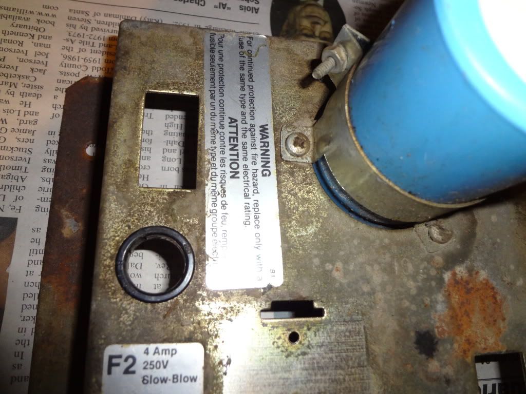

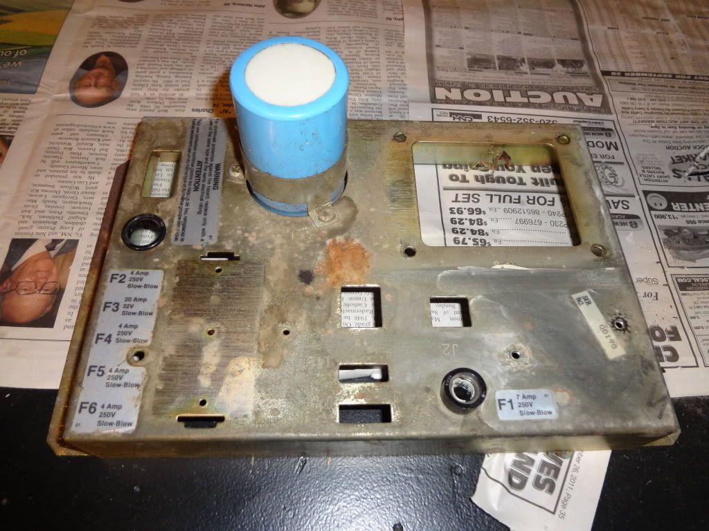

So I bought one of those Atari Transformer Blocks that old Troy had fabricated and kitted a few months back. I bought the kit with my Pole Position cockpit in mind, but as it is a very hard machine to gain access to at the moment, I kinda left everything in the package for a future rainy day. Fast forward 3 months. I decided that while I was waiting for some stuff to arrive to complete a few other projects, I'd clean up the Dig Dug cabaret I bought a few months back in the meantime. I never even thought about replacing the transformer block in here til I opened the back and took a lookie inside. What greeted me was a cab floor covered in 2-3 inches of debris from at least 2 mouse nests and possibly a chipmunk kegger. Fur, ripped up vegetation, turds, piss covered this-n-thats, acorns, peanut shells, etc. After a thorough vacuuming, sanding and disinfecting, I was left with a few stains in the wooden floor and a horribly tarnished, rusted and otherwise disgusting transformer block. Here it is after disassembly:
Close up of the plate surface (note to self: mouse piss is not a good metal polish):

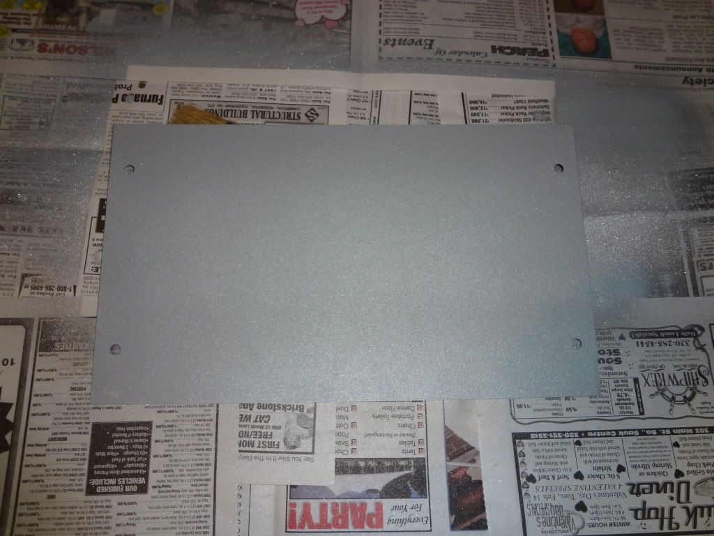

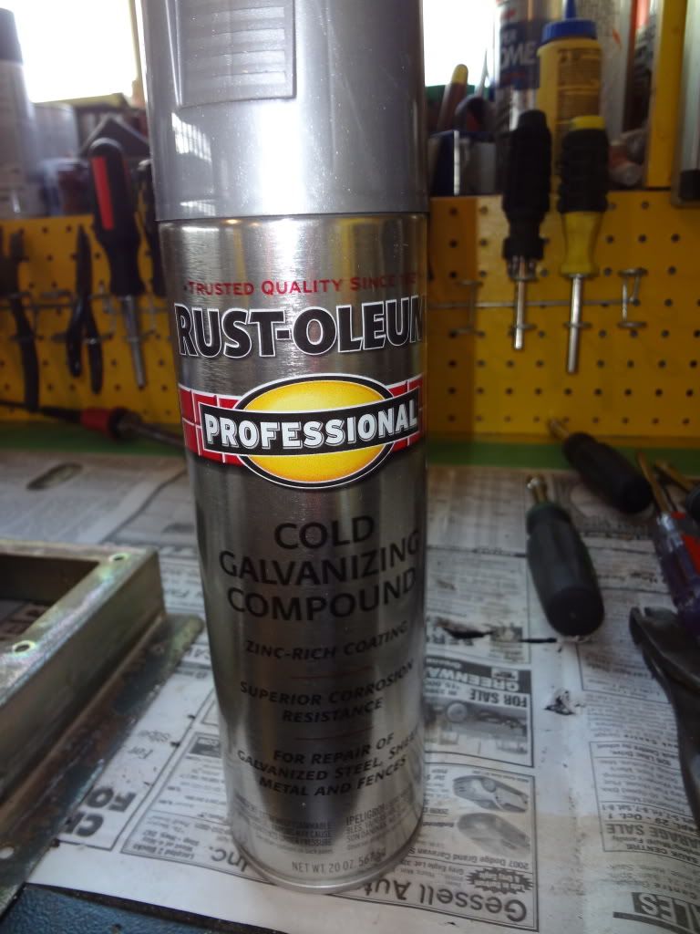

Almost forgot the base plate that sits underneath the power brick assembly. Much like the back of Fritz's throat, it was also covered in corrosive piss stains:
A little cleaning, a little sanding and generous amount of Rustoleum Cold Galvanizing Compound:
and we now have this:
