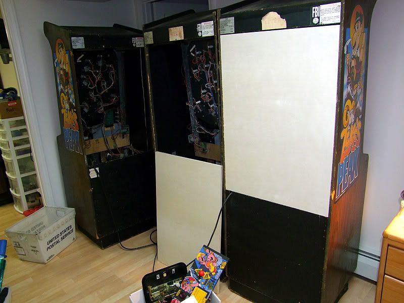

After cleaning them out yesterday, I spliced a temp cord on the one missing a cord, and it fired up and played. (Still have to test switches and get in the belts for the lift motors.)
The second one booted up and played as well.
The third would not boot up. After talking to a buddy, we decided to use the machine's main ground to test voltages... well I realized the machine didnt have a ground as the plug was missing the ground post. Just to be sure I had an "earth" ground to work with... I splice on a different temp plug with a ground... the thing booted up! The issue now is that it rings a tilt alarm and registers only "tilt" when it does boot up.
This is the nicest one, so I def want it to work. I will swap boards next to see if it is a wire short, or ma board issue.

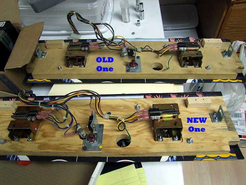

First, needed a different CP on Zeke #2 as there was a wiring issue and a JS issue. So I swapped in another CP I bought a few months ago (maybe a year) and swapped the wiring:

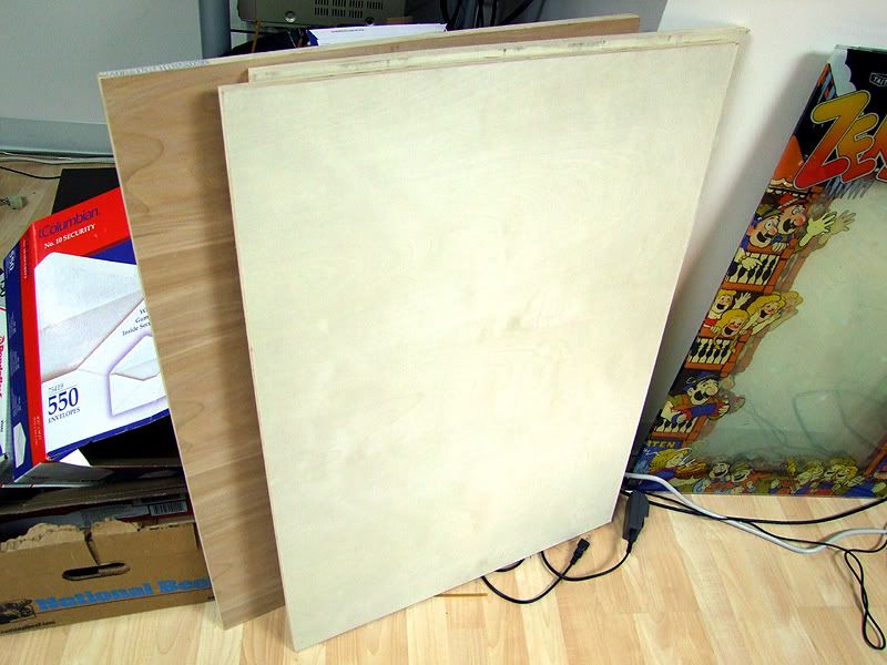

Then I went to Lowes today and had them cut me 4 back doors out of 3/4 inch hardwood finish plywood. I got enough to make a few new pedestals. I am going to build a new one for my ICB as well.
But these Zeke's now will have better backdoors and pedestals than they had from the factory!

Finished the doors today. Drilled, hardware, and added the brackets.
I am going to put felt pads where they sit on the game to prevent chipping down the line.
Again, this is finished plywood, 3/4 inch and they look great!
Made four doors!
Almost done!!!!
