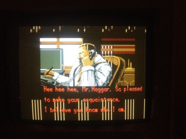

The "Unknown" ROMs may be faulty. There are some graphical glitches which I'll post pics shortly...
Now the glitches...
First glitch was simple to resolve. Culprşt was badly soldered EPROM socket...

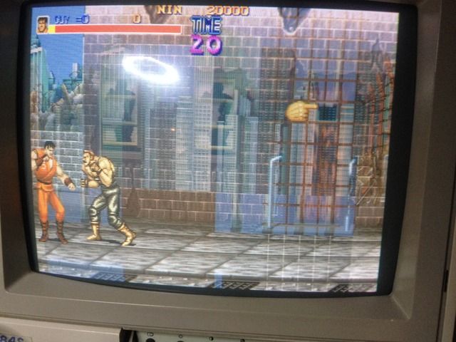

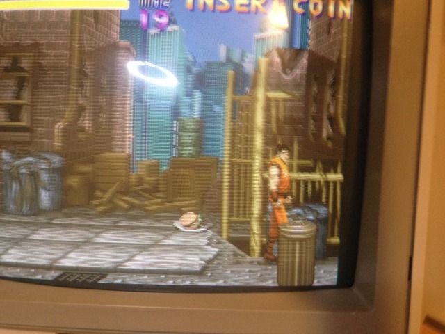

Second glitch is a bit more complex. If you choose Guy or Cody, on the first level you see some background glitch randomly appearing a split second once in may be 2-3 sconds...
Interestingly if you choose Haggar, there is no glitch :)

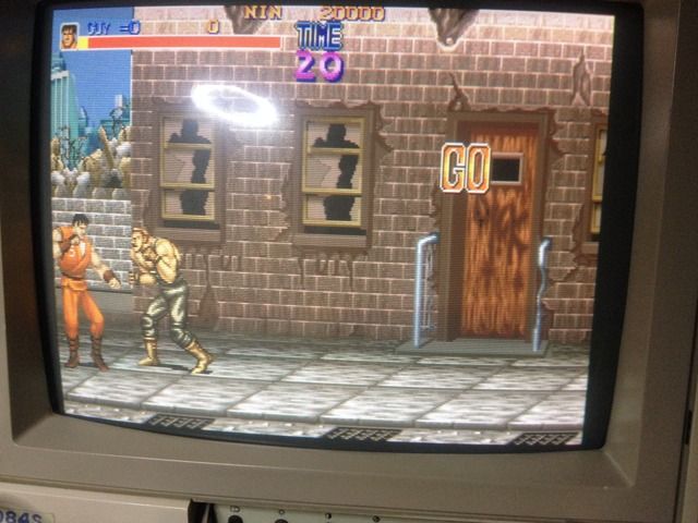

Normal screen...
And when the glitch happens (took tens of photos to catch this :) )
The last glitch is related with sprite priority. When you finish the level, you exit from either a door, window, stairs etc. the character is always infront of the exit. see the pic below
Any ideas?

The second glitch (the background image glitch which happens in split second) is resolved by replacing the couple of 250ns EPROMs with 150ns ones and replacing all the old single swipe sockets with new dual-swipe ones...
The sprite priority issue at the "level-end exit animation" of the character still remains. Although I have a feeling that it may indeed be a regular fault in these bootlegs since I have a cadillacs and dinosaurs bootleg PCB and same issue is also there...
