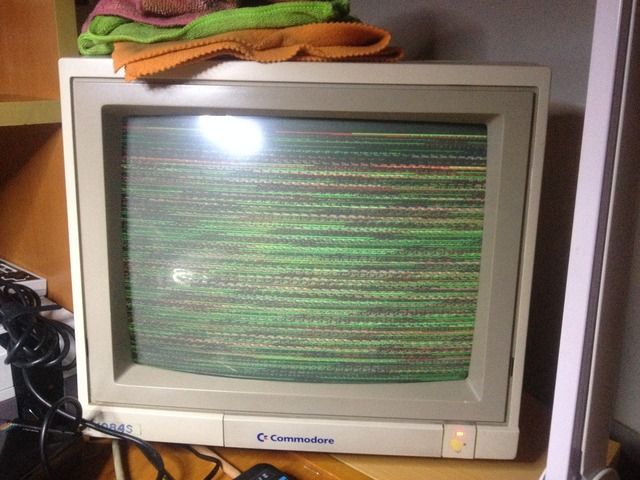

Hey guys,
I generally do not touch to bootleg PCBs but just trying to help a friend out here... He desperately wanted a Final Fight and ended up with this bootleg PCB due to lack of funds. Moreover the PCB does not even work :p
this is a photo of the PCB which I got from the internet. I just didn't shot an actual photo of it (I'll do when I'm home)
He asked my help so here we are...
I've checked the couple of ROMs and the game turns out to be Final Crash.
I came to the point to get the sound section working (replaced some caps which were knocked off and fixed the amplifier IC's broken legs) and put a missing xtal (used an 11 Mhz one salvaged from another bootleg PCB which looks similar to this one).
The result I got is this...

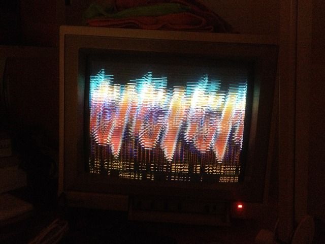

The game coins up and starts and the music and sound effects can be heard but the graphics are as in the photo. It looks garbage but some how consistent with the game graphics. You can tell the colors changes as the game progress on the background.

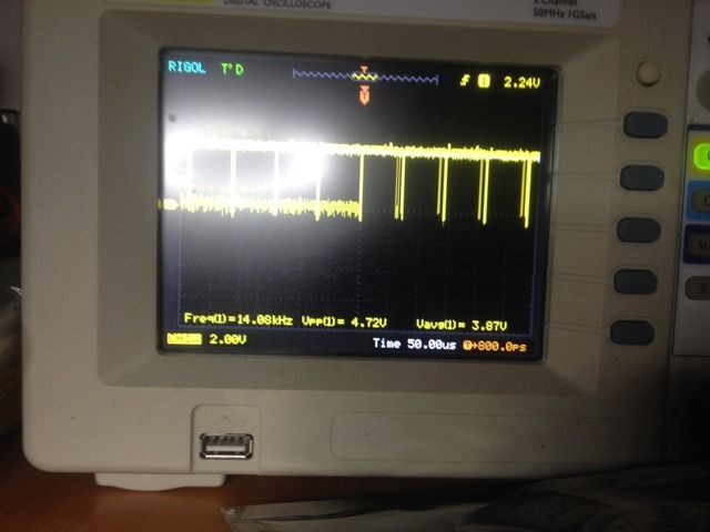

The video is like you're trying to push a 31Khz signal to a 15Khz arcade monitor. But the sync is around 15Khz according to my scope readings...
Could one of the PALs (most probably near GFX roms) might be faulty? If so anybody knows if the PALs have even been dumped for this hardware, somewhere?

CPS1 bootlegs are notorious to be badly engineered, most of times they 'spit out' not perfect SYNC signal like you have in your board.Anyway, I think the 11MHz quartz you used is not the right value.I can see your scope measured 14.04KHz on SYNC pin which is out of range that most of monitors can accept.Please, post a hi-res picture of your board.
P.S.
MAME driver of Final Crash reports that main CPU clock is 10MHz.Does your board carry a single oscillator/quartz to generate the master clock?If yes, check what you get on pin 15 of the 68000 CPU.

OK.Judging from location of the 22.1184 MHz crystal, it should generate the clock for the 68000 so it should be right but check if you get a 10MHz signal on its pin 15 to be sure.Now you should trace back SYNC pin back from JAMMA connector and figure out where video timing signals are generated.Most likely you will find the V-SYNC and H-SYNC are mixed tpgether (usually by an AND gate of a 74LS08)

You are right, I traced it back, passed 100Ohm resistor, an inverter and till the point they got joined, a 74LS00 (Quad NAND). It took about half an hour because the trace routed all over the PCB and jump to the upper PCB via the ribbon cables :)
I'll continue to follow...
Btw, I just changed that missing crystal with a 4.4336 Mhz one just for fun, got the exact same CYSNC (14.08Khz) but the PCB didn't boot (i.e. the game didn't even started on the background). Changed it back to 22Mhz crystal.
Also measured the clock of 68K on pin 15 as you said, it is 10.87 Mhz. This does indeed got changed with the crystal value. When there is no X-TAL1 (the missing one) the clock is around 8Mhz. When there is this 22Mhz crystal the clock for 68K is 10.87Mhz.

The other crystal (27Mhz) is the source for video signals. I also changed that one with a 32Mhz crystal the horizontal sync became 16.5 Khz.
Still, the video problem is there and doesn't seem to be related with the sync signal itself.

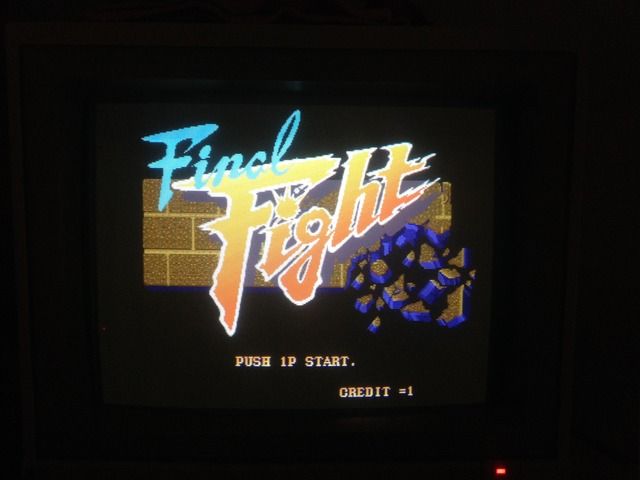

caius, you were right all the time :)
the crystal (27Mhz) which was already on the PCB was a complete B.S. Probably it was there from a previous repair attempt.
After checking the complete video generation section starting from the JAMMA connector (7407s, 74LS273s, RAMs etc which turned out to be OK) I noticed that an 8Mhz crystal in place of 27Mhz one generated a more stable video, which now you can guess whats going on...
Then I ignored what I've seen on all the other bootlegs at the operator's warehouse, and remembered you mentioned about the MAME source code, I snatched a 10Mhz crystal from a scrap UMK3 PCB and found a 24Mhz crystal in my parts drawer...
aaand bingo!
thank you guys...
