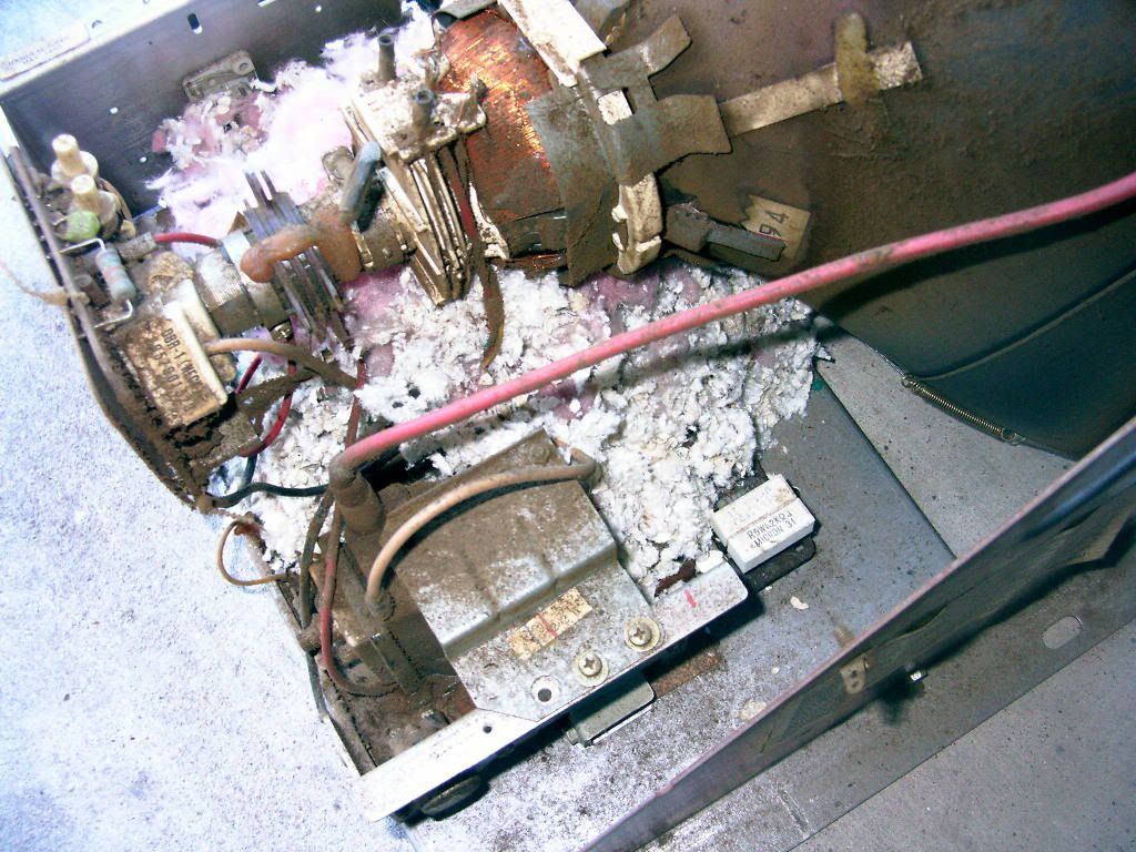

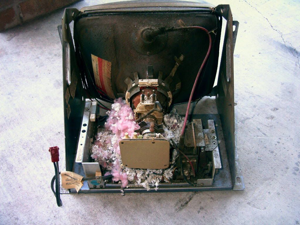

Hi. Got a crystal castles today and tore it down - going to clean her up. I am a monitor newbie, so have a question. In the past, cleaning the monitor with a steam cleaner (the SHARK!) worked well. On this one, it will need more - its an original monitor and pretty caked on with Bar skank.
Can i just remove the monitor from the cab (the metal chasis, with boards and tube intact) and hose it down? If it would fit in the dishwasher can i do that too? I run everything in the dishwasher for years without ever a problem - what about the monitor?
What do you guys do to clean em up? Thanks.

That looks almost like this one minus the pink panther fiberglass filler or whatever confetti that is. I will try the Simple green / hose down tomorrow (and it will rain up here to, so i get free water in addition).
Now i need to figure out how to remove the monitor...... four bolts, remove from back i would guess (Crystal castles)? i will look it up in the manual while i wait for everything else to get dishwashed. Thanks.

Make sure to discharge the tube and remove the chassis. Clean that separately. I use Simple Green sprayed on both parts and then I wash it off after sitting for 15 minutes. I sit the chassis in front of a fan to evaporate any water that might be caught under an IC.
