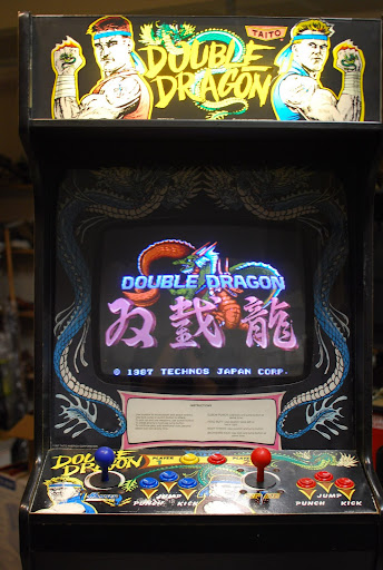

I know I've had a couple of threads already concerning Double Dragon, but I'll just say again that this was one of the first arcade games I remember playing as a kid (Came out in '87. I probably played it first in '88 or '89 when I was 5 or 6). My older brother let me play along with him and being 5 or 6 years old, it was just plain awesome. This is definitely a game that brings back memories and has serious nostalgic value to me.
Pros:

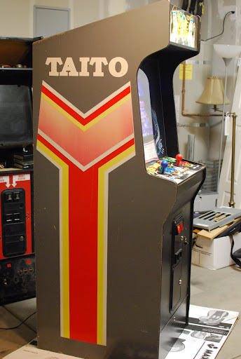

- It's an early dedicated Taito cab with the red/orange screen printed side art and is in great condition overall with the exception of damage in one bottom corner.
- Inside was clean, just dusty. Finally, a cab with no rodent crap or a million dead bugs.
- Monitor looks great after some adjustments.
- All artwork is in good condition.
- Control panel isn't half bad for being original. It could use a touch up.
- I won't need to restore the cab other than repairing the corner eventually.
Cons:
- PCB (Japanese) and JAMMA connector have corrosion leading to various issues. Luckily, I had another PCB to swap in there. I plan on replacing the entire JAMMA harness.
- JAMMA wiring was hacked up and done very poorly. My other thread about this.
- Missing top marquee bracket.
- Missing casters.
I'm very happy overall and always love the feeling of experiencing my childhood all over again.

Nice! I have had a DD on the backburner forever. Your control panel is def in better shape than mine. I'm gonna have to bust out my art skills and re-hand paint mine (I'm 95% sure it is painted instead of being a giant sticker...which is one of the reasons I dig original DD's). Another plus, DD2, 3 and Final Fight should plug right in just in case you get tired of DD1. :)
The parts that I got for one have a CP where the original overlay is definately a silk screened overlay. I wonder if they have some silk screened on wood ones like the stenciled cabs. Is yours a stenciled side one like the one eseyo shows here?
I haven't even taken pictures of my cab but it was coverted so I got all of the pieces for a DD kit so that I could restore mine.
Arcadeoverlays.com has a reprint CPO for like 40 that I'm consideringbut it will be way more vibrant looking than anything else in my art set.
My sideart is the other Taito version (gray background, red/black/white for the Taito art...same model as the one on the KLOV entry). I'll go out to the garage later tonight and quadruple check the CP, but I am really confident mine is painted based off how it is wore down. Again, I could be wrong though. :p

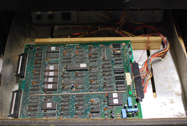

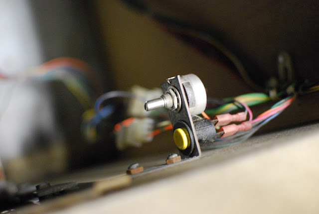

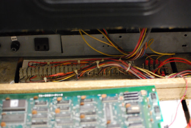

Yeah, it's super convenient. It's basically an open drawer where the PCB sits and you can remove it very easily. There's also an interconnect switch for the drawer in addition to the back door. Behind where the PCB sits is a wire hub where all the connections lead. Behind that, is the power supply and iso transformer. Swapping out the JAMMA harness will be really easy since all the connections are in one place. To my surprise, there's a metal volume pot and test switch attached to the back side of front panel right next to the coin door. I just adjusted the volume on the PCB to a moderate level and adjusted the volume in the cab. Great cabinet design to say the least.
PCB Drawer:
Wire Hub (whatever it's called):

Volume Pot and Test Switch:

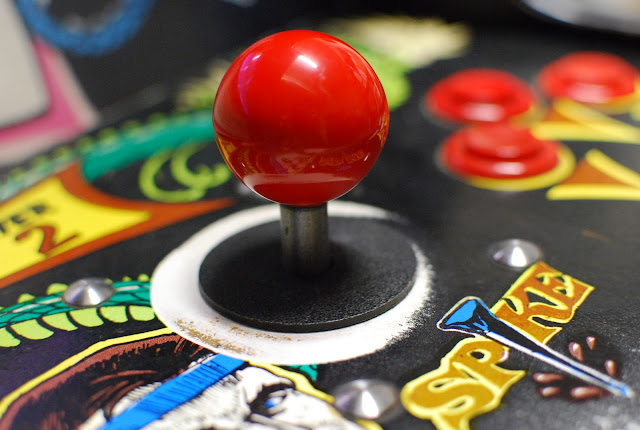

Also, thanks to Prairied1ll0 and Bob Roberts, I'm able to swap out the ugly joysticks for pretty Wico ball tops. Blue one is coming from Bob.
Ugly Joystick:
