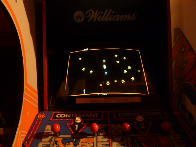

I offered to post up the images of fatherpain's multi-jamma setup that lets him play Smash TV, Total Carnage, and Robotron in a Smash TV cabinet. At one point, this was my plan as I have a Smash TV cabinet myself, but then I lucked out and found a Robotron cocktail local to me.
At any rate, fatherpain uses a 2-in-1 Jamma switcher with Smash TV / Total Carnage mounted to the RHS of the cabinet (from the front) and Robotron mounted on the LHS of the cabinet. He keeps Smash TV connected to one of the switcher's channels and then manually swaps the connector from robotron to total carnage by reaching through the coin door. Here is a pic of the complete setup (and what is that...blue bubblegum holding the the volume pots in place?):
Here is a close up of the clever Robotron PCB mounting with additional standoffs to stack the Robo pcbs:
And a close-up of the RHS with Mike's 2-in-1 switcher mounted above the Smash TV pcb (that is Total Carnage in the front).
And here is everyone's dream-come-true, Robotron in 25" Glory...
Next up, he is thinking of adding Tapper...but at this point, I'll let him field any of your questions....

I can't take full credit...I originally wanted to only have SmashTV and Total Carnage, which I why I picked up Mike's Arcade's 2in1 adapter.. Following JeffC's lead. He has details on his 720zone on how to pull it off.. Since I'm somewhat challenged in this type of stuff, my good friend Stuffmonger came over and wired it in for me...While he was doing this, I was telling him how much I'd like to pick up a nice dedicated Robotron upright and he suggested throwing the Jammatized robotron pcb in. Dunno why I hadn't thought of it before, Stuffmonger is like a mad, evil genius at times :) Once that was settled, we tried throwing in Clay's 8 in 1 multijamma with 5 daughter cards + computer power supplies but for some reason, couldn't get it to work or switch between games. Defeated but not broken...we went back to Mike's 2in1, which has been great. I just wish they would put out a 6in1...2 just doesnt seem enough. Manually swapping between robotron and Total carnage is doable the way its set up now, however. I plan on adding some jamma extenders to make it easier. I might try convincing Stuffmonger to try Clay's kit again, but I'm not sure if I like the idea of having 5 or 6 pcbs powered at the same time to play just one.
As far as the pots, no thats not bubblegum, lol. I got a little lazy and stuck them on using Silicone RTV. That stuff works great, even though it looks abit ghetto, heh.

I can only take credit for mounting the pcb to the wood.. Mark Spaeth (Hudsonarcade) actually devised the stack when I requested him to supply me with a jammatized Robotron boardset and adapter. Stuffmonger replaced the fingerboard and remapped the controls to work on Smashtv P1 controls. I haven't checked what Robotron P2 is mapped to, but itd be nice to have it to Smashtv P2 to not have to switch spots when playing 2P robotron. Hudson arcade also jammatized the Tapper boardset I'm planning on installing.

Thanks again m_mcgovern! Its pretty neat seeing the interest in SmashTV's possibilities. If anyone would like more detailed pix to duplicate any portion of this I will gladly take more pix. There's ton's of space inside SmashTV... To add additional pcbs, I might try adding a shelf or something, haven't had time to investigate.
